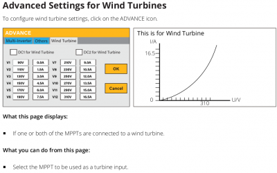

Hi @hanno - good question.
The range of hybrid inverters from SunSynk have a mode which can be configured to take input from a wind turbine.
Whilst the power would be input to the inverter using the same physical terminals as those usually accepting output from PV solar panels, the algorithm is very different.
SunSynk have allowed the user to configure the power/wind-speed curve within the Advanced Settings configuration menu. But information in the manuals is scant. Earlier editions of the instructions actually contained more detail.
The issue with wind-turbines is that they can't simply be turned off if the storage battery becomes full.
The turbine must always be presented with a load. Even if you understand the concept of a dump-load, you still require a fail-safe mechanism to switch it into circuit in the event of the inverter failing as well as the battery being at max capacity.
Users with domestic wind turbines invariably have very large energy stores... well beyond anything you'd consider implementing with Indevolt's technology. For that reason alone, I can't see them wanting to spend R&D time to design a wind-turbine option.
