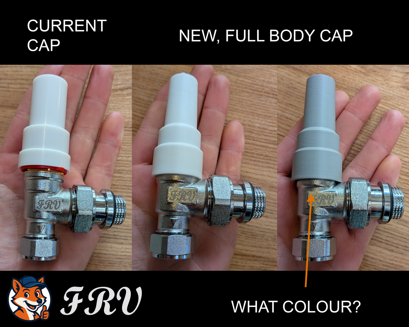

I have a quick question for installers and homeowners on this fine forum.
We're giving our FRV (Flow Regulating Valve) an upgrade, and I would value your opinion and input.
If you've not come across them yet then they help you to balance radiators quickly and accurately, giving you the same control you get with an underfloor manifold, but on a lockshield. Which means better comfort room to room, and lower running costs.
What's changing?
🦊 The cap now also acts as the lock (no red visible part)
🦊 The cap sits lower and locks in tighter for extra protection
🦊 We plan to supply two caps as standard. One will be white.
My question is - what colour or finish do you think the second cap should be?
Many thanks 🙏
How about white or any RAL colour at extra charge?  Just kidding!
TRV heads are available in black, white, chrome, possibly anthracite.  That probably covers most options.  For some reason Drayton decorator caps (at least the ones I have) are in pale blue, but I cant see anyone wants that colour.  The LSV caps I have are white.
I would personally suggest that nobody will complain about white, but if its practical to offer options then do so.
PS I wish I had these, but my system is now 'done' and its not going to get replumbed now!
PPS - I dont approve of waste and thus forum is all about sustainability.  Is there a way to avoid supplying two caps with every valve, its yet more single use plastic!
PPPS - could they be made in a way that they can also be used as a cap for the LSV the other end (for symmetry), if you have done the cost effective thing and NOT fitted a TRV.  Just to make it symmetrical.
I think that’s an excellent point James… way too much plastic out there.
@sune, does it really need the plastic cap? Is it exclusively for protection purposes?
As far as the colour is concerned, white will probably be the most ‘neutral’ for most homes. We’d go white.

@jamespa That is a great point about waste - and I think you're right. I think perhaps we need to think of carrying alternative caps as an extra on the shelf instead of in the box. We have a loflow insert now for low output rads, but that then means wasting the standard insert - so we're having them assembled as a loflow, pre-assembled set to combat that - which is dealing with the same issue you mention, so i should have been thinking along those lines already, so my thanks for telling me!
@editor good question - and yes they are needed as they provide physical protection for the gauge once set. They're pretty robust, but not enough to leave exposed in a boisterous household. In a calm household, inhabitated by people obsessed by heating, then perhaps visibly seeing the flow to each rad would add a point of interest!?
