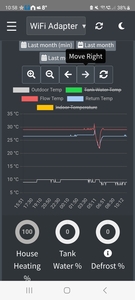

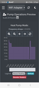

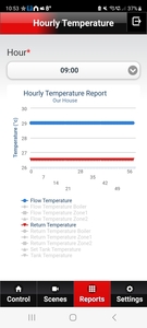

Yesterday it ran smoothly most of the day see images from Mel pump Mel cloud. It ran yesterday from 1:10pm to 9.25 am this morning with one cycle.

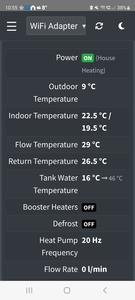

I've managed to drop the curve to 39⁰@-2 cold end and 27⁰ @10⁰ warm end, never been able to do this before as it would cycle. It runs at 29⁰ which it could do on WC, unfortunately won't go lower but at least it seems to have stopped cycling.
Rads warm rooms @29⁰ we don't heat up water to heat rads, then cool uhf. We keep upstairs wifi stat in master bedroom which is over unheated garage and we can get this up to 20.5⁰ but mainly 18.5⁰ /19.5⁰, all other bedrooms go over 21.5⁰. downstairs stat is in the hall, we have rewired to just have one stat downstairs this is set to 21.5⁰ but over shoots to 22.5⁰ which is our perfect room temp.

A little further down in MELPump you will see "Target heating temperature" which is the Flow Setpoint that Mitsi AA has chosen.
Impressive low frequency there though!
