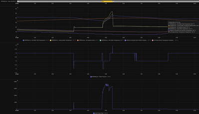

Thanks for the idea. Isn't that what happens at 3pm? For us, once the heating goes off at 9am, it very rarely comes back on until 4pm on cold days. If it does, it goes off at 7pm. This is when the DHW seems to cool fast (when it does it). This is a 7pm example from February. You can see the heating go off. I wasn't monitoring the outside temperature at this point.
From what everyone is saying, it would most likely be the 3 way valve in the cupboard next to the tank?

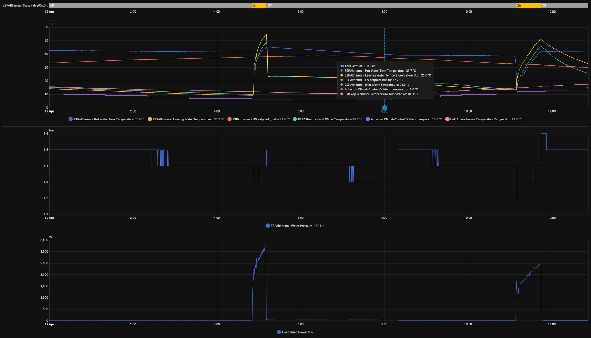

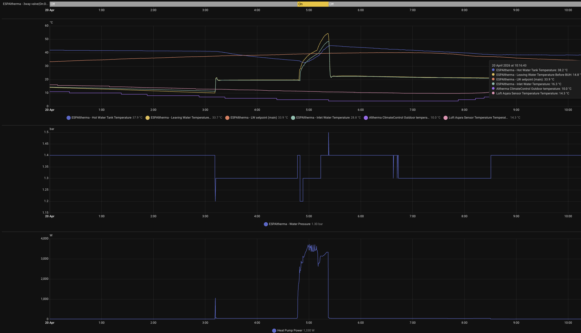

@jamespa That for the advice. This is normal how the house heats anyway. Once the house is warm enough the heating rarely comes on after the mid afternoon hot water top up. Now the heating is never on, yet yesterday and today the water immediately cooled after the water had been heat around 4.45am. In fact this morning it was above 40c until just after 3am. Then the heat pump came on for a very short period of time and then the heat loss kicked in until it was meant to heat the water. It then lost temperature again.
The heating is set to come on at 5am at 20c. It never needed to kick in so it is only doing hot water now.

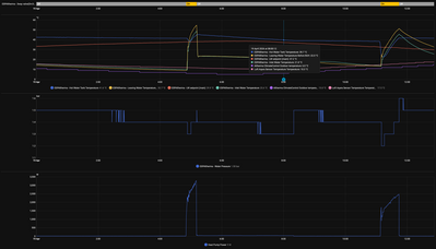

Hot Water   20 April 2026   8am   7pm
Hot Water   19 April 2026   8am   7pm

OK.  If the cooling only occurs when the heat pump is doing space heating and doesn't occur when it's not doing space heating then the most likely explanation is the diverter valve.  Either fully or partially stuck, incorrectly wired (in which case the problem would have occurred from when installed) or incorrect valve (3 way instead of diverter - in this case also problem would have occured from when first installed) or loose cinnection  Very unlikely but not impossible is a controller fault.
Hopefully that gives you enough info to work it out.
You could try manually operating the valve using the lever on the side, this may free it if it's stuck.  Otherwise you need it fixed.  Any plumber should be able to do (but  make sure they know it's supposed to be a diverter valve not 3 way it unless it's a controller problem, it's a pig of a job if it's the actual valve, fairly easy if it's the solenoid that drives the valve.  The latter is more probably but the former can't be ruled out.
One final possibility is that it's 2 on off valves and one has failed.  Relatively unlikely but again not impossible

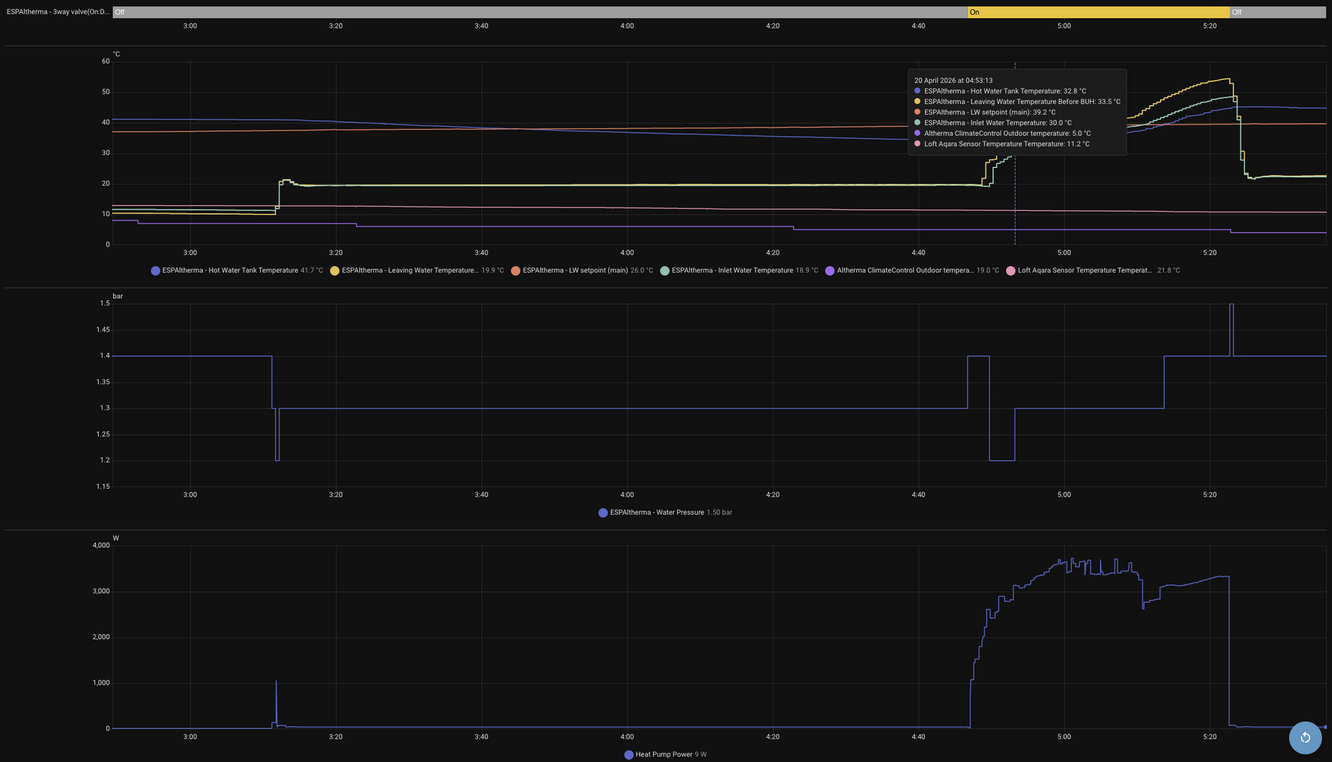

It is only the last few nights that I have seen it do when the heat pump is not running or even been running. The image below from the 20th seems to be very strange. The water temperature was fine, the heat pump came on around 70 seconds are 3am for what seems no reason. The tank temperature started to drop right after that. It is a zoomed in version of the above.
Screenshot 2026 04 21 at 14.01.30

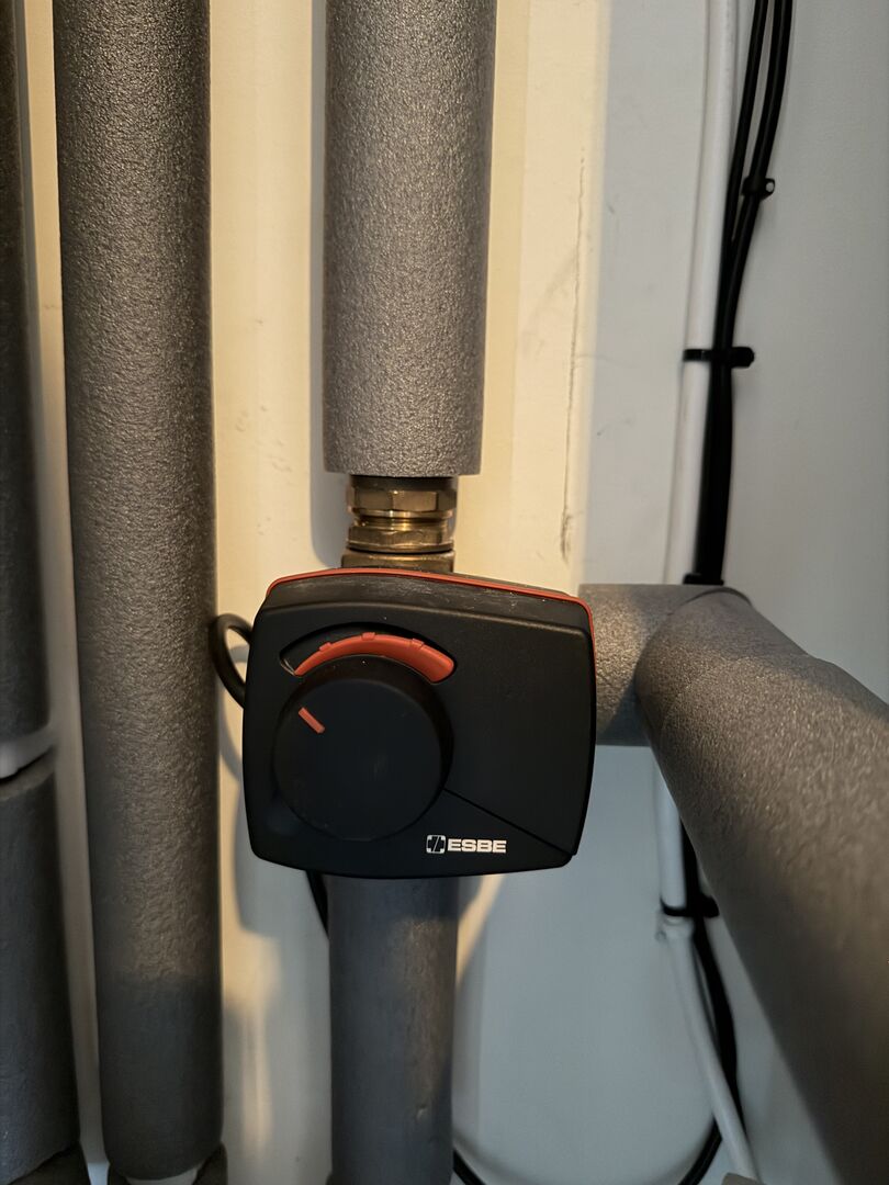

Of course it did not do it last night at all. Are you talking about this valve?
I would think so although the marking doesn't make sense.  Has it got a part number on it, are there any similar looking valves
Edit. Google lens says it's a constant flow temperature control valve.  If it's right then  not this valve and no idea what this valve is doing!  Hunt around for other valves.  Do you have ufh?

@jamespa Sorry, I don't know what a UFH is. That valve is the one that switches from hot water heating back to the house heating. It is the valve showing in the top of the screenshots. It is "off" most of the time.
