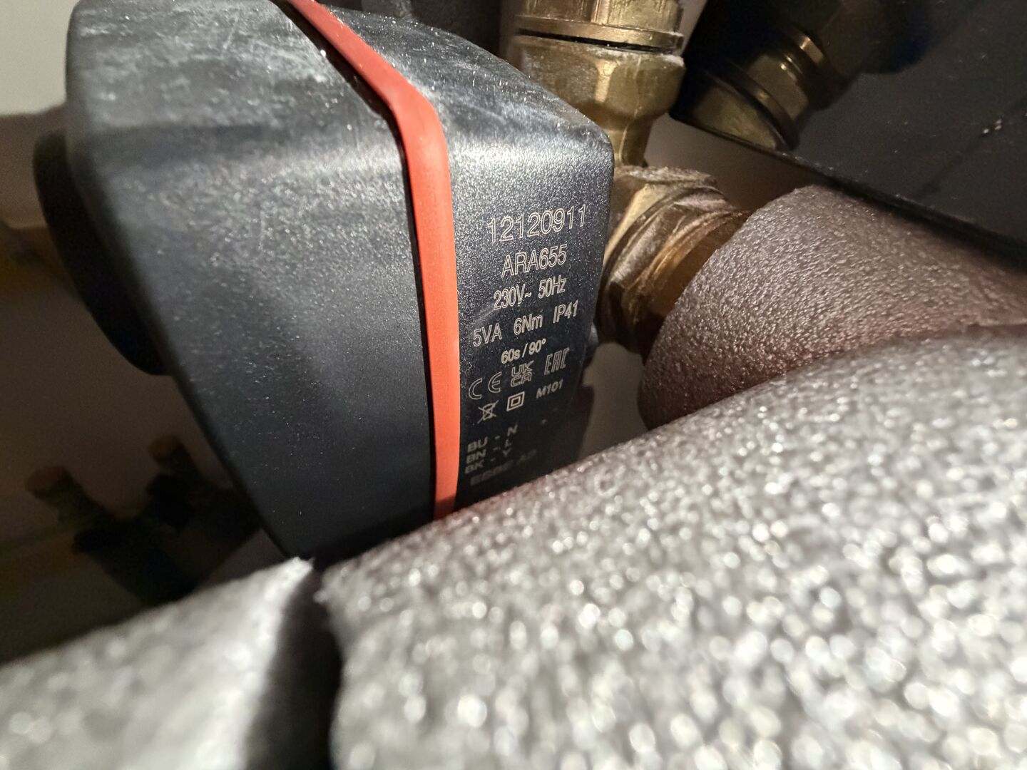

Can you check any part numbers on this valve, something odd here unless it's a being used as a temperature operated switch to avoid a power lead.  Has anything else changed since it all worked ok?

@jamespa @bash Thank you very much for the information. I am going to chase up the installer today. Just to round this off for @jamespa, we don't have UFH and these are numbers I could find
ARA655
12120911
IMG 1082

@bazcurtis
Contacting the installer is the thing to do
I note from the online description of this part:
  • Reliable and quiet operation
  • Can be used for both 2-point and 3-point control signal
  • Perfect match between the actuator and ESBE valve
The bullet in bold rather suggests the possibility to set it up incorrectly!

2) DHW directional valve not doing a full quarter turn and remaining partially open. This is the most likely.
To discriminate, simply turn on the heat pump circulator with the testing menu, or wait for it to turn on. In case 2, the DHW tank flow pipe should get cold because the heat pump sends cold water into it, and the DHW tank return pipe should get hot because the hot water that was inside it gets flushed out. Both almost immediately, it should be very obvious to the touch.
Your ARA655 actuator takes 60s for a full quarter turn. This is a relatively long time. Quite often, much quicker valves are fitted. There's nothing wrong with using a mixing valve as a directional valve, but... the heat pump drives this actuator with relays and there is an option in the settings or installer menu to set how long it should drive the valve to open or close it. So the issue may simply be that the time is set too short because the default value was 30s or something, and the installer didn't configure it.
You can investigate by watching the big button on the ARA655 and listening. It should do a quarter turn, full 90°, not 80°. The normal way to configure these is to set the time in the heat pump controller to longer than the valve needs (say, 120s) to ensure the actuator turns until the limit switch triggers, which guaranteed it has done a full 90°. So you should hear the internal limit switch clicking, the motor stopping immediately, then sometime later the relay in the heat pump IDU should click, having done its job. If the motor stops right when the heat pump IDU relay clicks, but you don't hear the actuator limit switch clicking, then it probably didn't go all the way.
