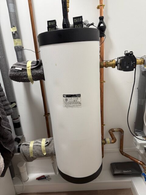

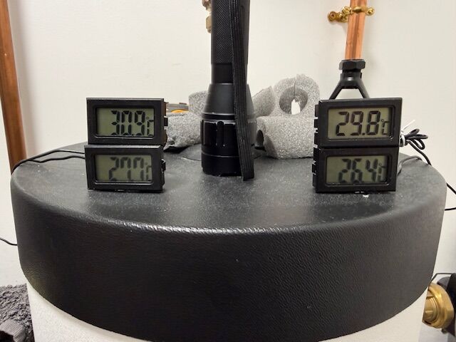

Buffer tanks, you will hear from many others on this forum, should a system have one?  I do and it’s part of my problem.   Over this winter I started to appreciate that the flow rate out of the primary circuit needed to match that of the underfloor secondary circuits.  With the help of 4 temperature probes I was able to get close to balancing these 2 flow rates.  In the attached image you will see that mixing is still occurring in the buffer tank, in the order of 1C, this was the best I could achieve.  The result effect is that I am wasting energy, and the return to the heat exchanger is being increased by 1C by the buffer tank, so also loosing efficiency. Also making thermal cycling worse.
There is a setting in the Installer Access where you adjust the primary pump speed, I currently have about 1.4 m3/hr on the primary and 23 l/min across my 11 underflow circuits.  The underfloor is fully open with no wall thermostatic controls.

The sizing must be at the base of it, compounded by a failure to set it up.
To be fair the building is very tricky - we really only need heat in two rooms - most of the building is near passive but we have an old part that is not (by miles).  We might be better with two systems really (hindsight being a useful thing).
I need to understand the defrost cycles better - we only ever run the system overnight on low rate electricity so I miss a lot of what is going on!  The unit cycling is definitely better for using the call for heat from the thermostat.
Sounds like I was on the right track on the buffer - I will struggle to get it balanced - partly because I can't get enough water out of it into the system (unless I can throttle the HP back a good deal) but also because the amount going out is dependent on the call for heat and the different parts of the building behave very differently.  Some sort of bypass circulation might help on the flows if not on the efficiency perhaps.
