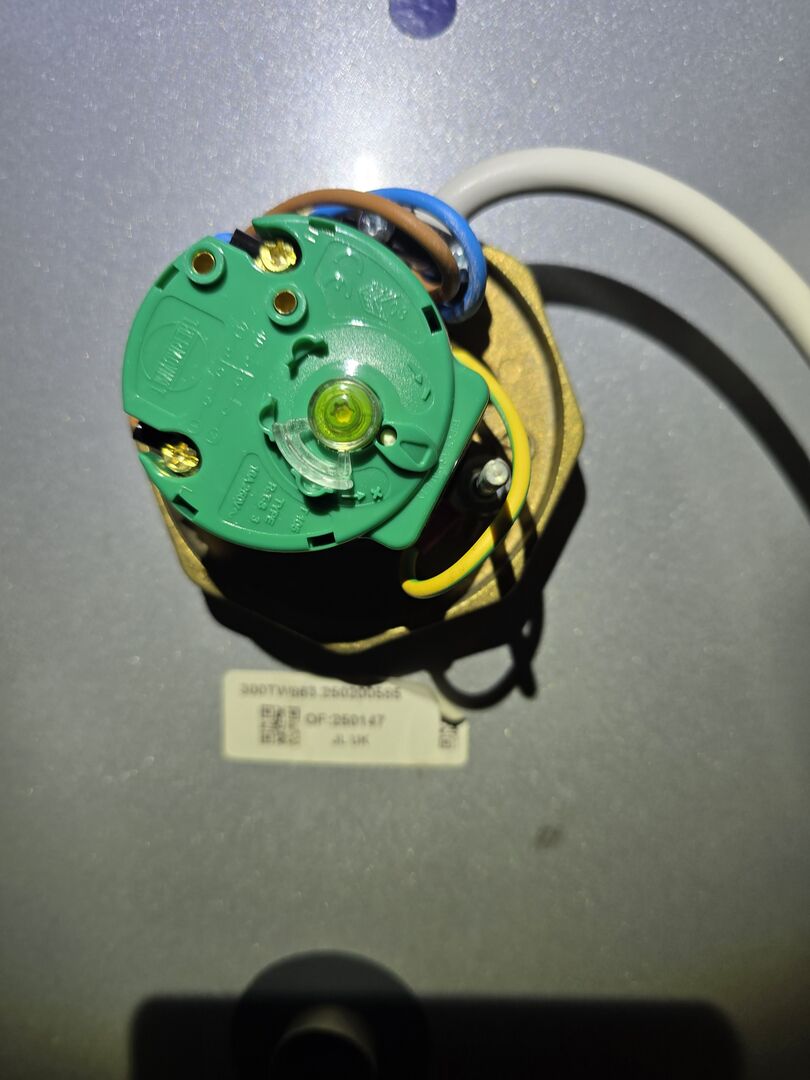

The thermostat for the immersion is a Thermowatt T105 RTS 3 (pictured) which, from what I can tell, should be able to well-exceed 60 degrees on the max setting (which I've moved it to).

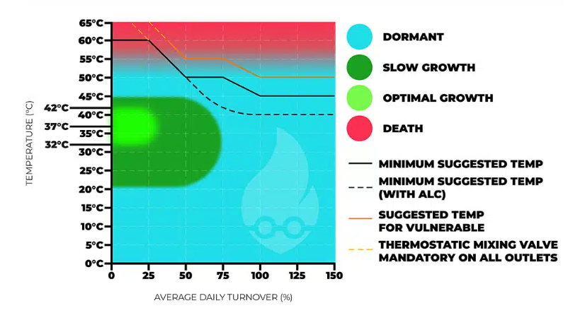

First; Legionella bacteria, this chart from Heat Geek is informative. Legionella bacteria is dormant above 45degC, and killed above 55degC. Temperatures of 60degC or higher kill bacteria almost instantaneously, but water stored at 55degC for several hours will also kill bacteria.
There's far greater risk of contracting Legionella from a mixer tap outlet or shower head outlet, as these often have microbial growth on them, are in contact with air, retain some water at room temperature and supply water in the ideal temperature range for Legionella growth. If you're really worried about Legionella, or in a vulnerable group, sterilise your taps and your shower head periodically, and run taps and showers full hot for a few minutes a week. The risk from an unvented sealed and pressurised DHW cylinder is very low.

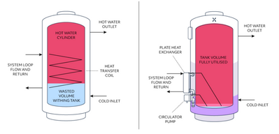

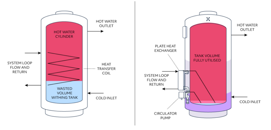

Second; a DHW cylinder with internal heating coil does not store water a constant temperature. Not all of the volume in an internally heated hot water cylinder is utilised. It uses stratification, hottest water at the top where the outlet is, cold water at the bottom where the mains inlet is. In between is a boundary layer between hot and cold. As you draw hot water off, that layer rises, eventually reaching the hot outlet whereby the hot water suddenly runs cold. Nearly all domestic how water cylinders without secondary return pumps or external plate heat exchangers are like this.
Similarly, an electric immersion does not heat all the cylinder contents up to whatever temperature the immersion thermostat is set to, but about 2/3 to 3/4 of the cylinder volume. Below the level of the immersion heater element the contents will remain cold. The heating coil in a cylinder is more effective at evenly heating the contents of the tank, because is has a much larger surface area than a small 3kW immersion element, and often extends almost to the bottom of the tank.

Posted by: @9jwr9So figuring out why the immersion is seemingly cutting out at 59 is the objective, for now
The built-in thermostats on most immersion heaters are very approximate. They are more of a safety thermostat than a control device. Mine is maxed out at an indicated temperature well above 60degC, but doesn't heat the DHW contents beyond 57degC as indicated on the cylinder stat before it starts cycling on/off on the thermostat.
