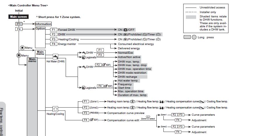

There is no way to disable room influence, Had to look at the settings, They call it room temperature control, and you got 3 modes, Fast, Slow and Auto. Right now its on Auto.

Looking at the Zone settings on FTC 7, it does use FTC 7 thermostat to balance the curve/flow temp.

Sometimes the way to get things to operate in pure WC mode is to set the curve on the controller, then just turn all the 'room temperature set points' (third party and if necessary on the controller) to max. The heat pump then thinks that the demand isn't satisfied, so keeps pumping water at the WC setting which is what you want. To get this to work you would of course need to ensure that there is no adaptive mode (where the heat pump modifies its own WC curve) operational.
Without an FTC7 in front of me I probably cant add a lot more, but for sure (well 99.9%) there will be a way to do it.

This is the part of your query that is currently puzzling me, as none of these modes are familiar to me from someone who has played around with the FTC7 on a regular basis.
I'm away from home currently, but will take a look this evening to see if I can find the settings you're referring to, and I should also be able to record footage to point to how I can set up and amend the WC curve from the FTC7 screen. This sounds like it might be useful to figure out where the differences in set up currently are.
