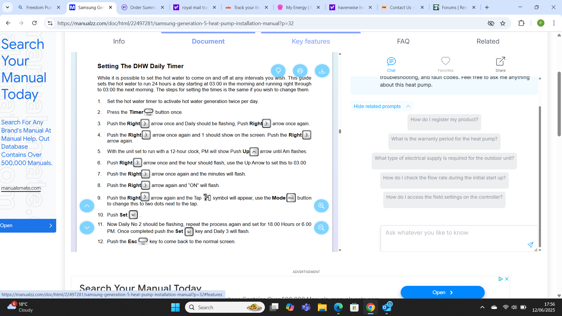

Searching on line I found a set up off gen 5 manual for introducing Daily dhw times but as far as Ican see its only 3am to 6pm for hating water but that doesnt suit the tarrif times . Or can it be for three times activated.

I have put in some DHW time settings with the help of my attached info on gen5 DHW settings , so I will see if they work . I am not sure if I also need to tell the controller of off times as well . At the moment I am working on the premis that on the day hours if the water is at the right storage temps , then there would be no need for the HP to switch on , except that after 12am the system detects that a drop in temperature happens after a bath has been run and I am hoping this new timing set for 4am in the morning negates that , so will see the energy use tomorrow.

I notice in Daily timing for DHW that there only five slots and I am trying to do 3 cosy on and off timings , which should be 6 slots .
However the first time I set up the controller on Dailys' The tap icon was missing so I have gone over the settings again it seems to remain this time . The last and remaining slot which is the after a bath reheat I have left to come on at 3.00am but cant put in and off time .The only other thing I have done , as I mentioned earlier is setting the clock time on the controller to 24hr and when I set on/off times in DaIly I assume I set for say 3.00pm I use 15.00.Any instruction I get for slots from user manuals ask to set am/pm which doesnt come up on screen settings.
Sorry , this rambles on but simply trying to explain as best I can.
I hope what I am doing is correct if any one has better instructions which I have searched for online then please let me know.
