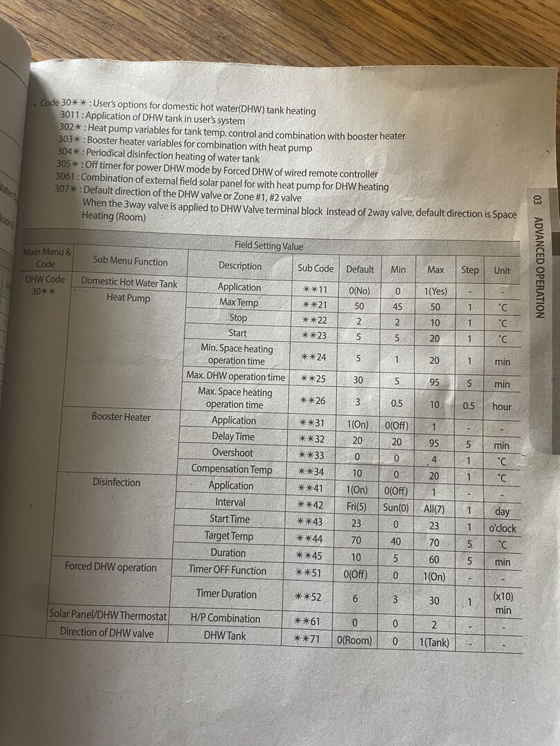

could it be something to with FSV settings as the system is still reheating when it detects temp drop. Like this:
IMG 2387
Suggestion being 3052?

Regarding your suggestion for FSV 3052 , it is just a timer to ensure that the forced DHW setting (expensive) can't go on forever. It's default setting limits the forced DHW time to an hour.

Im guessing its an FSV problem.  If you are prepared to can you post the values of the 10xx and 30xx FSVs and screenshots of the timer settings I am happy to take a look

I guess your installer set it up to reheat continuously.  Somewhere, whether its in the FSVs or the main UI, you may have to tell it to use timer program instead - it may not suffice just to enter the times.  If you post the FSVs and screenshots of the timer settings we can take a look.
This slightly cryptic note in the manual suggests that there may be some limitations, the bit after the 'or' in particular.  Im hoping this is just bad English grammar not a serious limitation on how it works.
