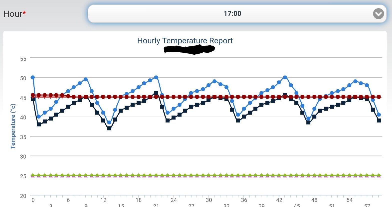

The system was short cycling
short cycling
I couldn't achieve internal temp above 19+ regardless of water temp
I couldn't achieve a delta 5+ even with pump running at 8l/min (manufacturers guidelines state optimal is 17l/min) and the pump wouldn't couldn't achieve 14+l/min.

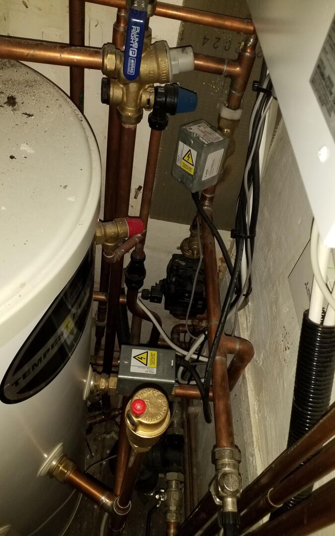

In the interim 3 months the installer had decided to add a 32 litre volumiser in my loft (without my consent) on the longest radiator run in the house not on the main return (although I'd like it on flow for defrost cycles).
  • My entire system was less than 40 litres
  • Narrow delta continues
  • SCOP remains 2.3
  • Half of the heated volume of water is now located outside the insulated envelope of my house (wasted heat not included in SCOP)
  • Balancing radiators is a nightmare (7 vs 50 litres)

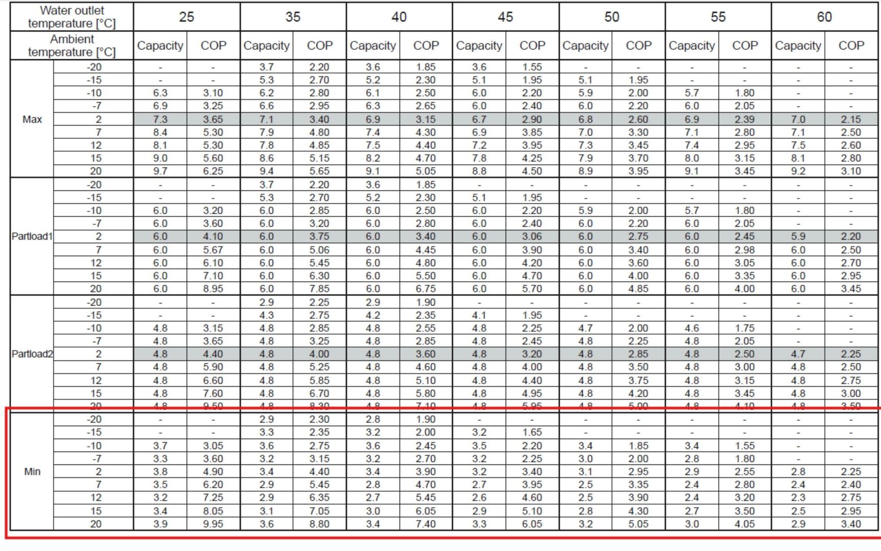

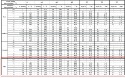

The same sales manager has defended this ridiculous decision sharing the turn down datasheet
turn down data
HELP?
  1. The manufacturer's home help technical team have yet to respond to my request for 5kw turn down data- can anyone help?
  2. I've argued this would appear to show that my ASHP is too large, not that I need a bucket of warm water in my loft- Anyone have any resources that might confirm this please? The missing K3 in the kitchen would add volume but not much.

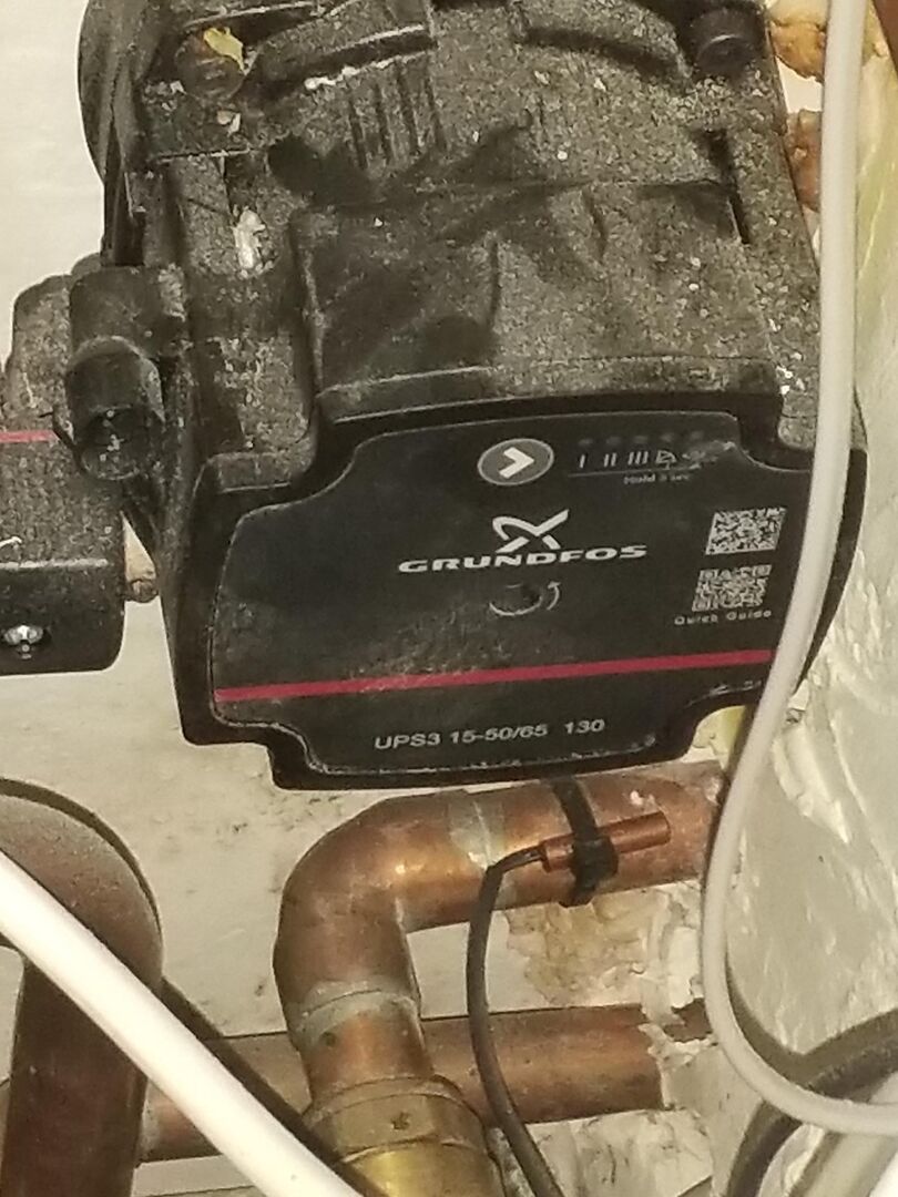

Pump is below:
pump
For metering I've relied on outputs from the ASHP manufacturer's controller. (low =8, med =11 high =14l/min) Its on the 1st floor same height as highest radiator. x3 heating loops which combine before the main ASHP feed and return.

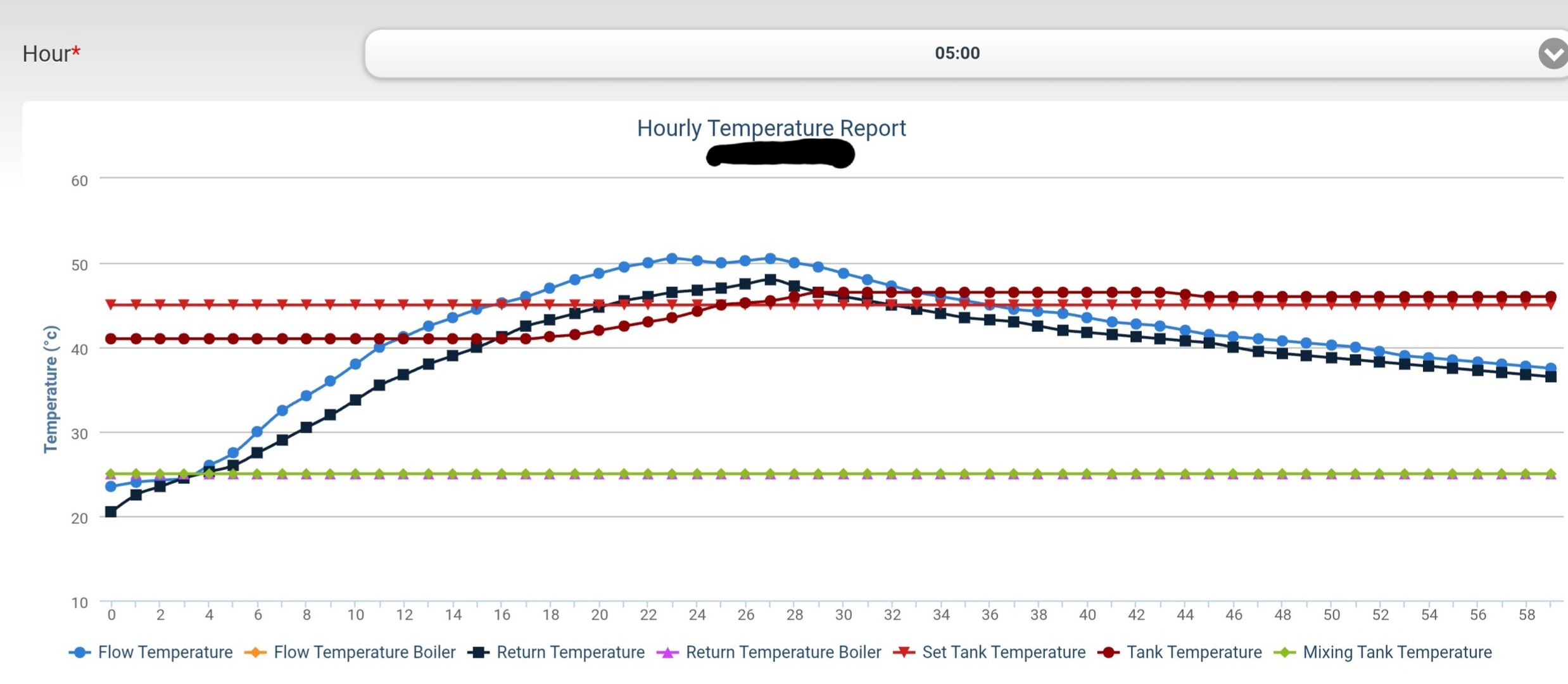

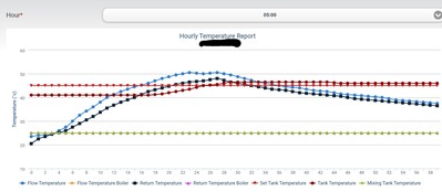

Today DHW heating cycle (roughly delta 5)
dhw heating cycle
 Thanks again

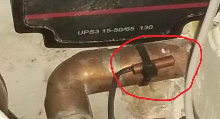

This:
RHH
being uninsulated ensures that any reading out of this will be completely off (unless you're interested in room temperature).
(@ashp-bobba)
Posts: 505
@mphb Which sensor is that supposed to be? I assume the primary flow or return?
All of the pipework should be insulated but yes especially that probe should be.
 MPHB
(@mphb)
Posts: 31
That is something @bart would need to tell us. I have my probes firmly insulated and actually added thermal paste in order to get as close as possible to the temperature of the flow.
I cross my fingers that maybe it is this probe throwing the primary or return values off and so makes the ASHP work so inefficient.
