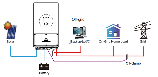

Here's their diagram, but with my re-labelling:
So, you can ignore @majordennisbloodnok 's (excellent) explanations of 'Load-first', 'battery-first' etc!
Those are concepts used by Growatt.
You need to make up a table to show which devices/appliances you might wish to have connected to each port.

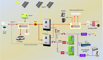

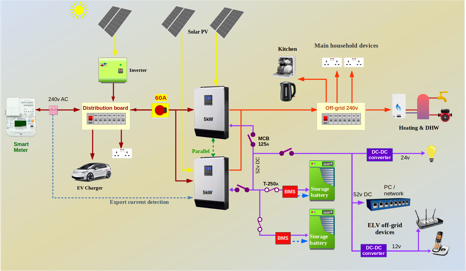

Let's start with this diagram:
a: On the left is your existing Consumer Unit (Distribution Board) to which an existing (green) solar inverter is connected.
b: I've placed two new (Sunsynk) inverters in the middle.
That's to demonstrate how you can start by installing one, and then add more later.
c: The Sunsynk inverters are operated in parallel-mode, and have a single current-clamp (sensor) which limits what they can export to the grid.
Because that sensor is to the left of the main Consumer Unit, they can still supply power to circuits which are connected to it.
d: To the right is a new Off-Grid Consumer Unit.
Anything connected there stays 'live' in the event of a power-cut.
... provided you don't attempt to draw more power than the Sunsynk inverter(s) can supply of course.
e: I've separated each battery unit from its BMS (Battery Management System) and protection fuses/trips.
If you're going to use Fogstar enclosures, then all that is integral to the unit.
f: I've added a number of devices at lower-right which can be driven directly from the DC output of the battery(ies).
There's little point in frittering away the precious power constraints of the new Sunsynk inverter(s) to convert to 240v AC
and then use a 'transformer-plug' to go back to low-voltage DC again!

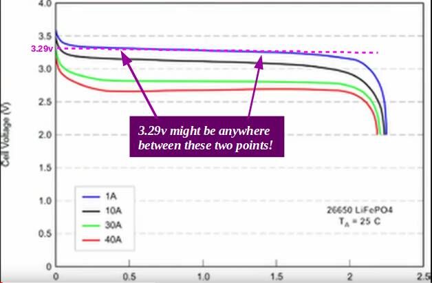

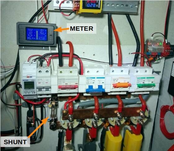

Posted by: @nazuro1041Regarding the SoC. I was under the impression that the fogstar battery and sunsynk inverter talk to each other, such that the inverter does know the SoC.
You're assuming that the BMS in the battery is more capable of knowing the SoC than the inverter is.
In practice, neither is much more accurate than the other.
Each unit is trying to measure the 'at rest' voltage of the battery, whilst there's current flowing in or out.
Nothing is actually standing still, and there are losses to calculate too!
Here's one of my layouts which does use an external/separate Colulomb Counter:
The shunt carries the full DC current passing in/out of my four battery stacks.
At the upper end, it is bolted to a copper busbar which can supply up to four inverters.
In the photo, only three inverters are wired in.
The SoC meter (made by PeaceFair) has a readout which is surprisingly accurate.
But there's no data-port accessible to me.
So I can't take the data from that display into my own control/monitoring system.

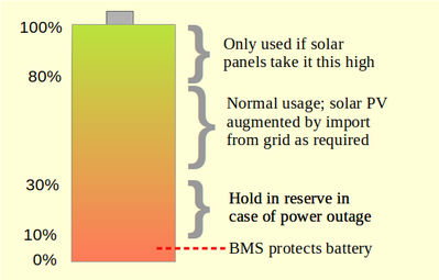

Posted by: @nazuro1041I've seen use cases elsewhere online similar to what I'm asking for, where the battery is charged overnight at 6.7p between 00:00-07:00, and then used during the day.
That would apply if you have no solar-panels supplying the battery(ies) vie your new Sunsynk inverter.
If there's going to be enough solar-input the next day to run the household, then don't bother importing from the mains during the previous night!
Every time you charge/discharge the battery cells, they lose a small amount of their total capacity.
That's reflected in their 'lifetime'.

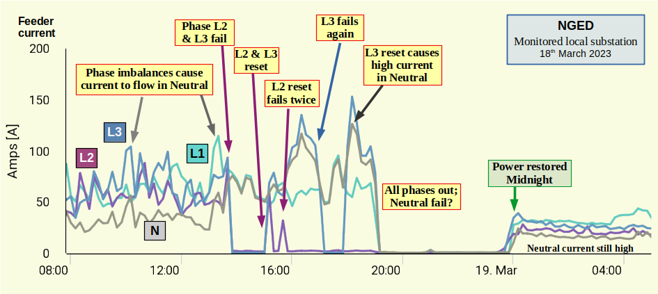

3: You really do need to consider the effect on the grid at times when you wish to export.
Exporting on one-phase causes losses due to phase-imbalance at the local substation.
Those losses in Britain are presently around 10% of total generation, and rising.
The transformer and the cabling emit that energy as heat.
It causes thermal stresses, which results in breakdown of insulation.
It also results in current flowing in the Neutral.
When phase-loading is evenly-spread, then there should be no current in the neutral wire, which is why it's usually smaller.

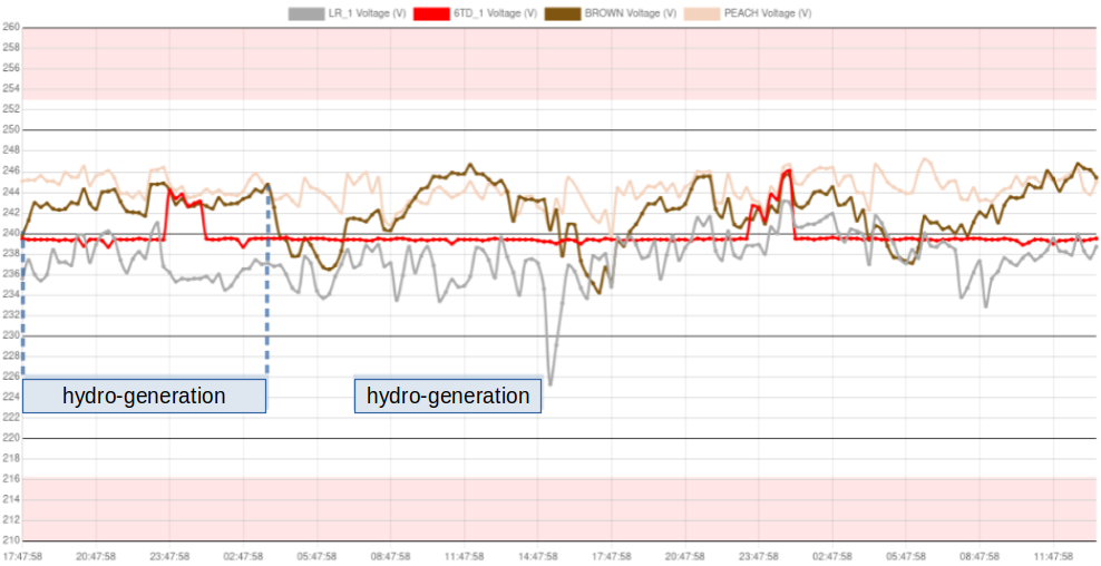

Here's a plot from a local substation which exhibits high neutral currents.
Despite engineers being on-site, they were unable to prevent an outage.

In addition to my Point-3 above regarding Losses due to Phase-Imbalance, we need to appreciate the effect on line voltage when we import/export.
To export to the grid, our in-home inverter must raise its output voltage above that of the grid:
I can see the effect of export to the grid when looking at LV monitors.
In the following plot, the Brown Monitor has a 400kW hydro-electric station 4.8km distant (measured 11kV cable length).
You can see the voltage rises associated with that generation starting and stopping
The second (morning) generation period has a much slower ramp-up/down, which is typical of how that site is usually operated.
Under the G98 Regulations for grid-tied devices, they must cease operating if they detect the grid voltage falls outside the range specified in Section-27 of the Electricity Safety, Quality and Continuity Regulations (2002).
For LV connections that equates to an operational range between 216.2v - 253v AC.
Outside of that range is highlighted light-red in my grid-monitoring graphs.
That's a slight over-simplification because the response time is also a factor.
But I hope you get the idea!
That G98 specification is an integral part of all devices approved for grid connection in UK.
If a device 'sees' an under-voltage or over-voltage, it must 'disconnect' itself from the grid.
It may not reconnect until it detects that grid voltage has returned within the operational limits for a randomised period of about 1-minute.
That's a safety feature.
It prevents our in-home inverters electrocuting engineers who are working on a grid fault.
Consequently, if my Battery Storage inverter exports to the grid above the 253v threshold,
then it's entirely possible that the inverters in neighbouring houses (on the same phase) will disconnect themselves.
Since that effectively reduces the line-voltage, my own inverter could then continue exporting.
I'm unlikely to be aware that my neighbours are being disadvantaged.
Of course, that might also also work in reverse.
I could be installing a nice new inverter and battery storage unit with the expectation of receiving income for grid-export,
only to discover that my inverter is continuously being taken off-line by a neighbour's installation!

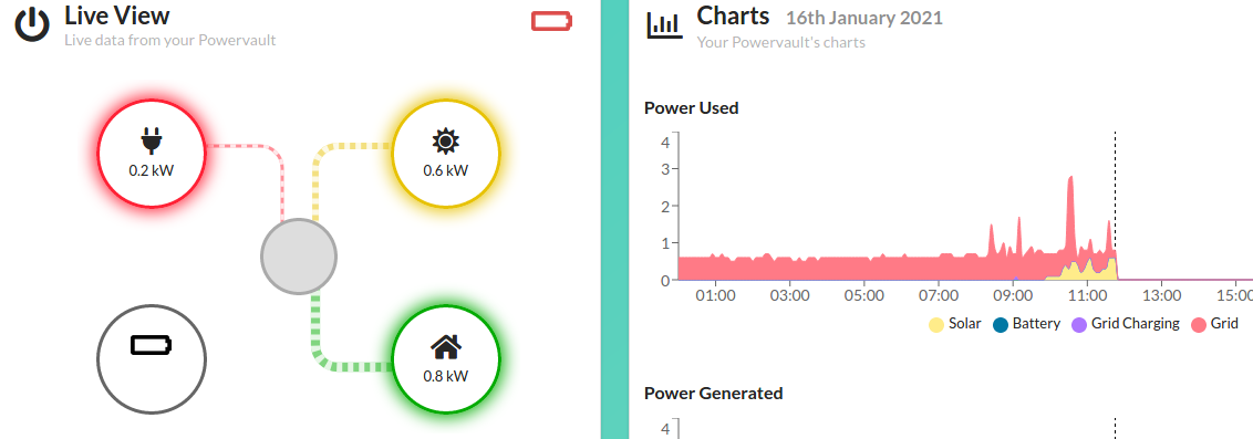

Here's that happening on a PowerVault Storage Battery back in 2021:
Despite there being 4kW solar array available on a bright, sunny winter's day,
the grid export suddenly drops to near-zero at midday.
If you're relying on export for financial income, you could end up being disappointed through no fault of your own.
