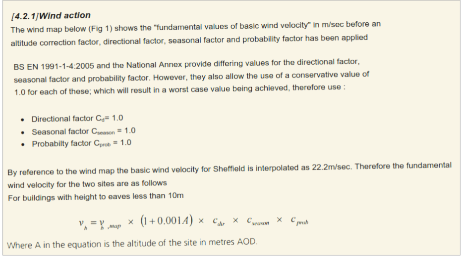

@toodles I sail, so have a feel for what wind can do. At 80mph, there is approx 79kg/m2 lift. 10 panels is 20m2, I make that 1600kg lift, max.
I’ve scared myself now! I’ve got 20 panels on one of my roofs, that’s 3000 kg going the wrong way.
@papahuhu My installers insisted on a structural survey of the roof to ensure that it was safe for the uplift. I think I paid about £150 for that extra surety. Toodles.
We had a reroof concurrently with the PV install, it was 60 years old and although not leaking was at the end of its useful life. Plus, if you can demonstrate the reroof is necessary as part of the PV it qualifies for the same VAT relief on materials and labour as the PV. I think we were pushing it to get both sides done when the panels were only on one side, but the roofers didn’t protest too much. It was 12 pallets of tiles alone, all in all it saved me about £4k in VAT.
It’s a long winded way of saying that I now know there’s 4500kg of tiles on each side of each roof, so at least the force of that is downwards and must counteract some the lift. I don’t know if a survey was done beyond the basic structural loads calc that MCS mandates.

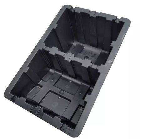

There are ground-level frames and angled 'buckets' which allow PV panels to be placed on the ground, and comply with this planning rule.
The bucket system allows for ballast to be placed below the panels to prevent them being blown away to the Land of Oz.
Wind Lift:
The installation manual for Fastensol roof-fixings contains diagrams and calculations to satisfy the wind-lift requirements that apply in UK
The above link is from Midsummer Wholesale, who supply the Fastensol range and other (rival) roof-rail systems.
They will supply direct to (competent) end-users, rather than just trade installers.

@transparent A very informative Forum at that! Our system was installed during post-covid supply problems and the buckets we were to have (a rival company) were O/S, so the installer chose to use frames which are all bolted together and have the panels bolted to the gravity hugging system that also had blocks of ballast at each intersection of the frames.
