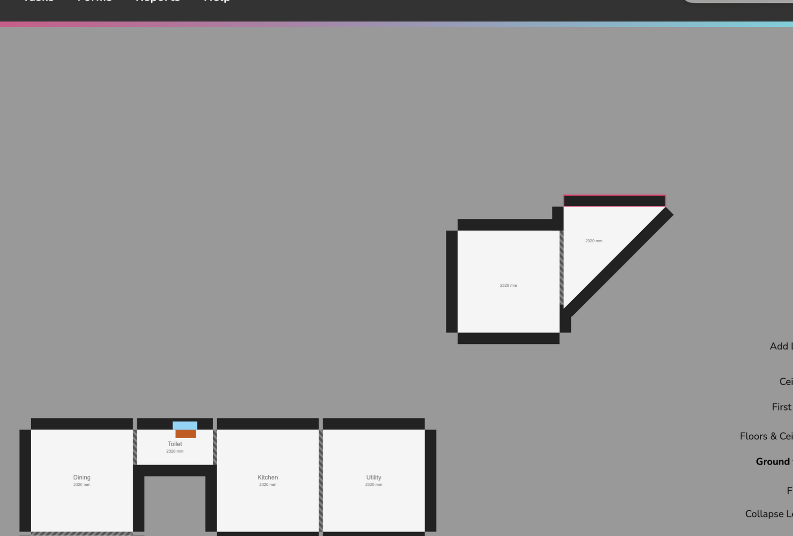

Heatpunk Floor plan issues

Now I understand why heat geek and others charge for the next step of getting a price for an install, this takes ages 🤣
Most companies will do this for you for around £200-£300 as it takes and while and a licence software that is normally expensive.
I'm still undecided on A2A or A2W at the moment and having been burned by bad tradesmen then the past I like to be as fully informed as possible so I can verify what they're telling me. AC in summer would be nice too.
I have solar + battery already but a heat pump will be a hard sell to my wife so it has to go well when the time comes.
My house is a 1998 with 10mm copper mircobore with some 10mm plastic too, so really not ideal for A2W. Rads are mostly type 11 too.

This is the layout. The garage is currently getting converted, so that has:
150mm PIR floor insulation.
The walls are brick, 70mm cavity (based on a bore hole for vent) with blown in cavity insulation that may be patchy, then block with dot and dab.
Suspended timber floor the rest of the house, uninsulated.
Loft insulation is 270mm with the top 170mm being recent.
The bay window may not be insulated on the roof area.
Built in 1999.
Conservatory currently has no insulation but a lightweight solid roof, there is a door separating but is an internal door with glass.
All main house windows are UPVC double glazed from 5 years ago, along with front door composite.
Last weeks gas consumption was 275.77kWh, this month to date 1274.37kWh. Cannot seem to find annual consumption in the app.
Also got a 1.5kw electric radiator in the conservatory.
Working from home so house always occupied. 2 adults + 2 kids.
Cooling to the living room and upstairs hallway might be enough to make the summers more comfortable, currently lugging a portable AC up and down in the summer months.
Got 3.6kW solar + 3.6kW 14kWh battery
Rear of the house is 144 degrees and South Yorkshire area.
