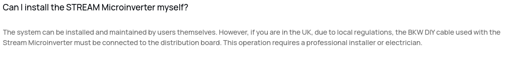

To retain compliancy they must then be installed by a qualified electrician because they should be hard-wired with a lockable isolator and a Type-A or Type-B RCD (or bi-directional RCBO) within the Consumer Unit. The installer must undertake the required on-site tests and notify the DNO within 28 days.
What proportion of the EcoFlow units sold in UK do you think have been installed to satisfy all those criteria?
Or do you think it's likely that they are being plugged into a 13A socket?
Here's the FAQ from EcoFlow's own website:
This post was modified 8 months ago by Transparent
Not sure I agree about your comment on the RCD requirement, I'd need to check the Regs but I think that depends on the installation arrangements, need for additional RCD protection of concealed cables and the inverter manufacturer's recommendations, so not always required.
As for what portion of the installations comply with G98, realistically I doubt anyone knows, presumably you would need to know the total number of units sold in the UK and the number registered with the DNOs, to then calculate the proportion correctly registered. I doubt that data is available, or if it is, unlikely to be published.

Here's what I received from the Standards Engineer who was responding to points I made about Plug-in Solar last year:
Both BS 7671 and EREC G98/99 would require the installation to be completed by a competent installer with sufficient skills and training (approved qualifications).
The use of protective device – solar installation will emit a small DC current into the AC circuits and therefore the correct choice of RCD is required (the is a risk that a RCD would otherwise become blocked by the DC current / won't work) i.e. the upstream system would generally have to be altered to accommodate the connection of the PV equipment.
