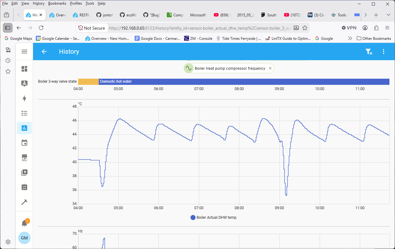

I agree with GrahamF about the Smart Controller manual. Some of it has confused the hell out of me especially around temperature correction and even hysteresis. With our old GSHP the hysteresis behaved as I expected: if there is a 47c target then raise the temp above it and when the temp falls some degrees below it then kick in the heating. However, our DHW does not hit the target of 47 at all but cycles somewhat below it (with 6c hysteresis):
I have manually had to reduce the target the last few days for the central heating to get a look in.
I will reduce the DHW schedule to a few hours in the morning and afternoon but I cannot understand the mechanism which switches off the compressor when the DHW hits around 45.5c.
