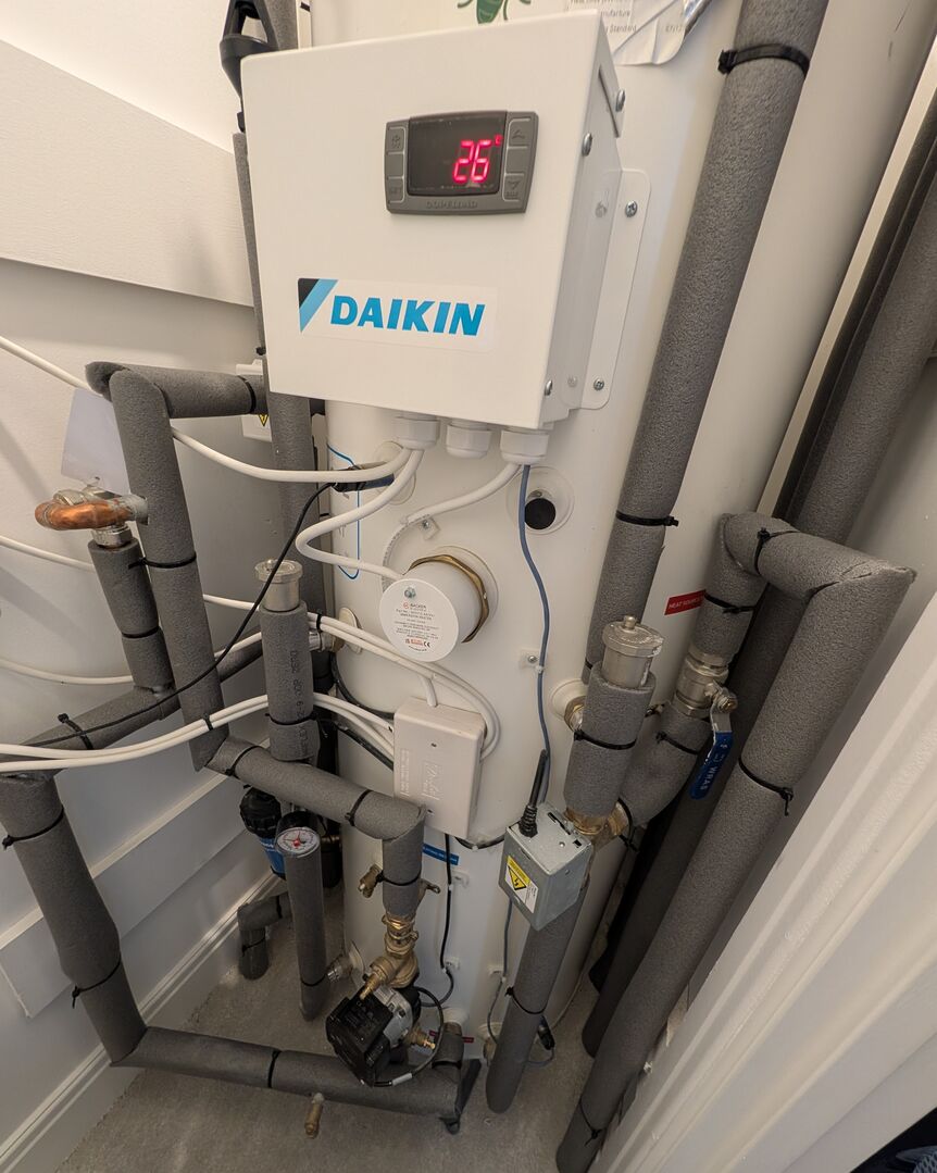

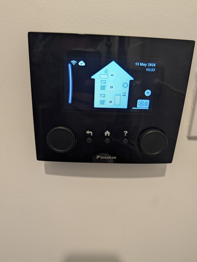

So its a Daikin Altherma 3M in a new build that has 2 zones with hive thermostats. I've attached a couple of photos of the controls/cylinder. No system diagram and nothing left for us beyond the manual.
I've got my head around the WD curve but its trying to understand how what I've established is a Dixell controller on the cylinder
works with it... From what I understand, the current buffer tank temperature is 26c and its set point is 30c. It needs to be +2c from the set point to trigger the circulation pump but in my simple brain, if my WD curve is set to 25c for current temps, then the pump won't ever activate but then obviously flow temps change but the set point doesn't so I don't know what to set it to or what I should do with it
