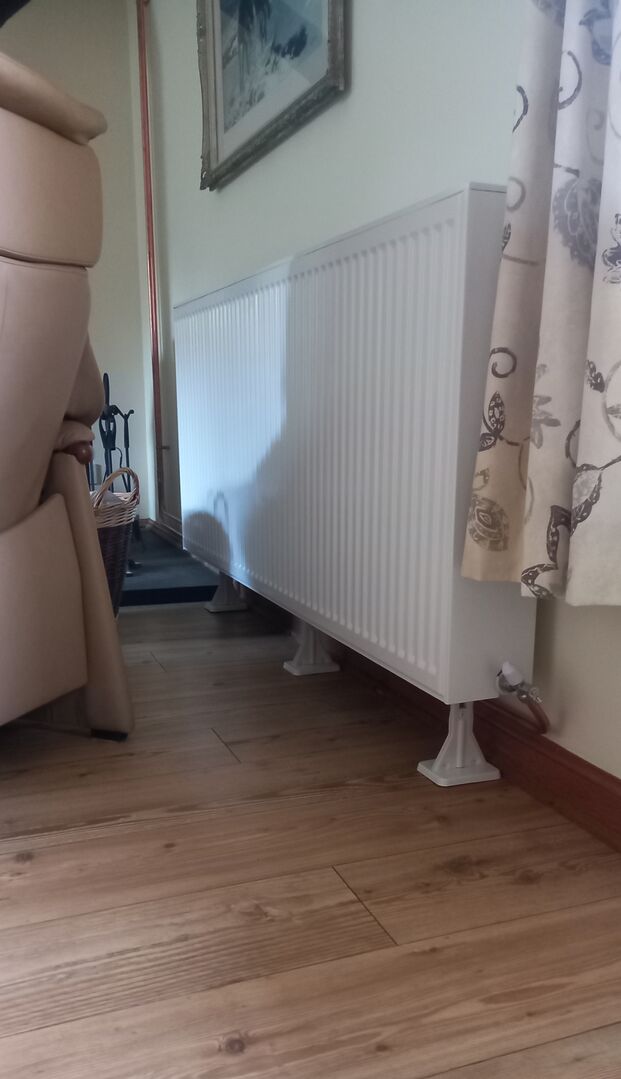

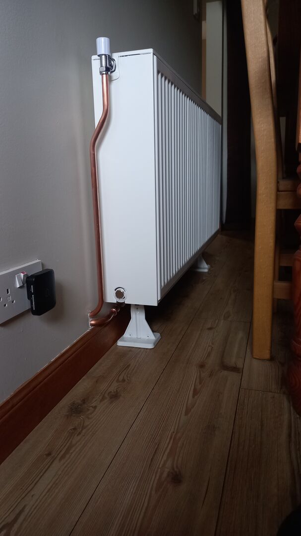

My neighbour is a plumber and said I would need to fit dwangs (reinforcements) behind the plasterboard to hang big enough radiators for my retrofit. He was unaware of the floor standing brackets from Stelrad.
I originally saw them on cityplumbing at over £60 which I thought would be a pair... but that's each. Stupidly, Wolsley are basically the same shop in the same building with the same stock and we're 1/3 of the price!
https://www.wolseley.co.uk/product/stelrad-k2-k3-freestanding-foot-single---hardware-pack
https://www.stelrad.com/wp-content/uploads/2014/08/Stelrad-K3-Floormount-Instructions.pdf
With some careful measuring to position the height of the wall brackets, the radiators are stood on the floor but still hooked onto and restrained by the wall brackets.
The 700 x 1600 weighs 96kg when empty.
