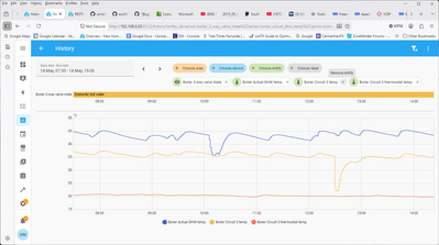

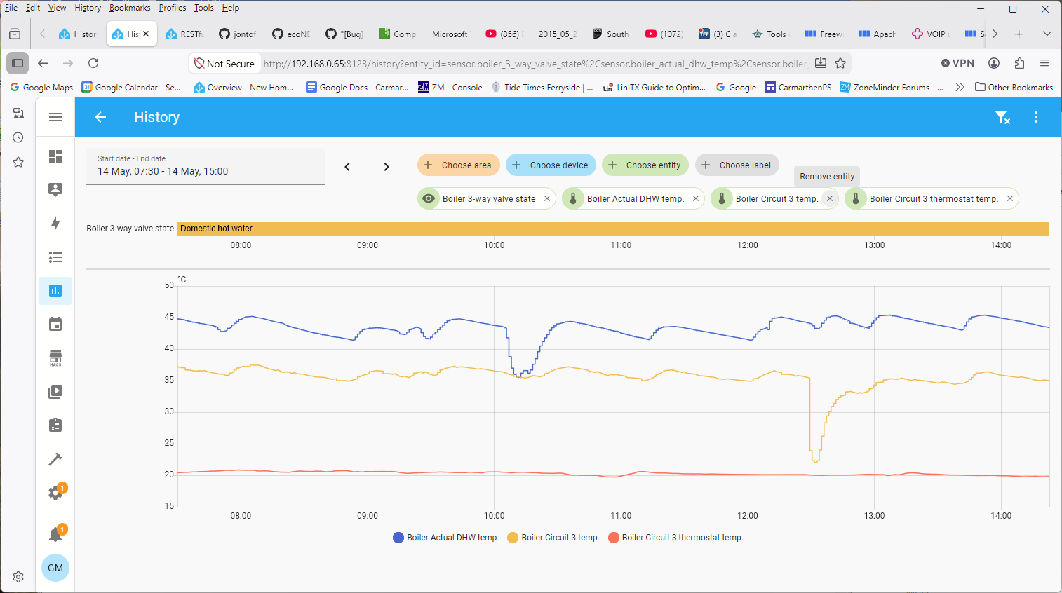

Early days for us as the ASHP has only been running a couple of weeks. I have it connected to Home Assistant with a standard Econet300 integration but I am attempting to enhance the REST integration to obtain other metrics including the energy usage.
I should mention that we had a GSHP in our previous property in the Brecon Beacons. This had a Raspberry Pi interface. In 16 years the technology has advanced tremendously!
There are a few aspects of this particular system which confuse me:
- How hysteresis works - certainly not like I understood it as our DHW temp never reaches the target;
- Why circuit 1 assumes radiators as emitters;
- Why Econet24 reports Circuit1's actual temp as that of the ASHP - Circuit1 cannot have a temperature sensor;
- Why Circuit2 has gone missing from Econet24(!);
- How the heat pump's target outlet temp (Service params - read only values) is calculated;
- Why are there temp corrections set on DHW, Circuits, "Setpoint temp. correction - heating" in the Service parameters.

I know that the system is configured to give DHW priority, but I think this one is configured such that the target is not reached but the compressor stops. (The hot water cylinder is not a Grant model as we needed a solar coil. It is a UK Cylinders 200l model.)
