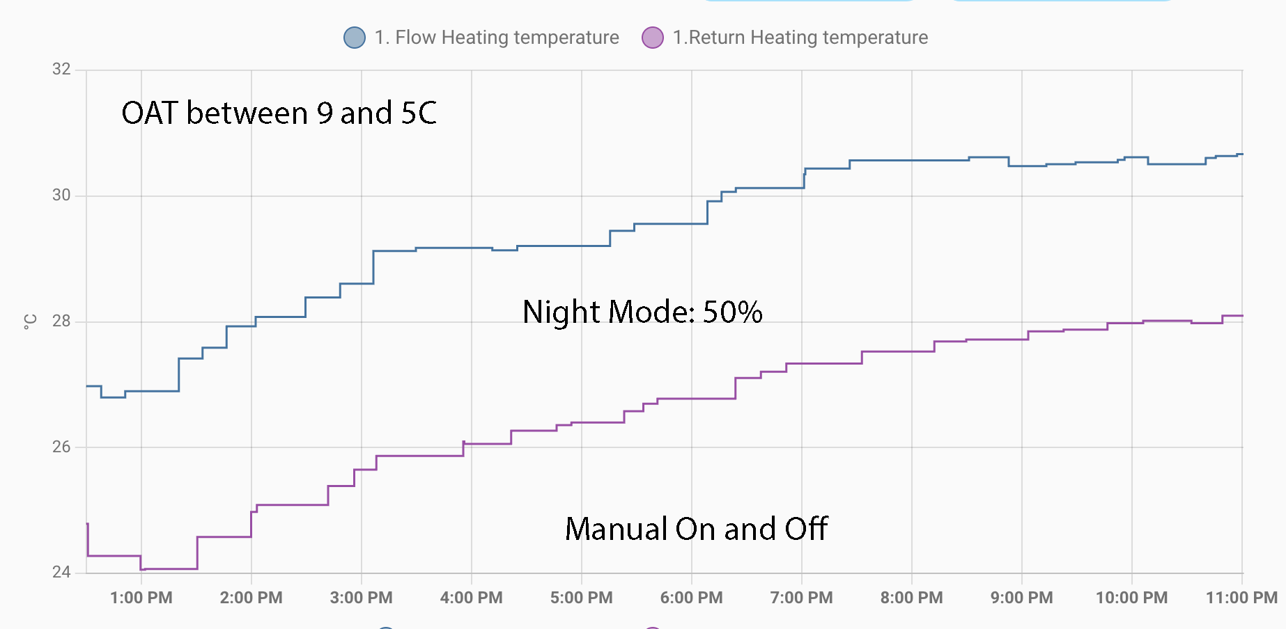

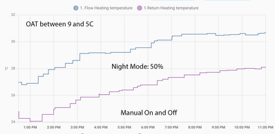

JamesPa Below is the plot of yesterdays run (30 Nov).  Surprise NO THERMO OFFS.  Ran for 10.5 hours.  Im afraid it's a fluke!!!
I have always expressed the view that the HP is oversized, as you have found the Night/ECO setting, I turned it down to 50%.  This is the result.
It's not a sustainable way to run the heating.
Does it tell us anything else?
I am looking at setting up the WC.
