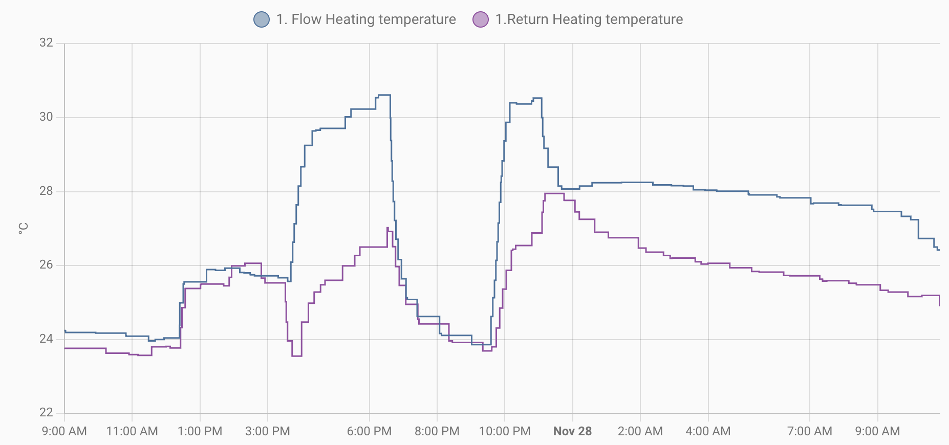

No, the fact that flow temperature reduces by ~3-4 C during nighttime hours (I havent yet worked out the exact hours) regardless of whether defrosting is occurring.  Until you posted your latest graph it was at least plausible that this was caused by defrost, even though the evidence wasn't quite consistent.  Your latest graph shows the reduction  but no defrosts.
This one, from about 11pm on.  Thats not thermo off so far as I can see, its a deliberate reduction in FT.  Thermo off occurs earlier, at around 7pm.  Look at the difference between the curves.  As a secondary point I would also question whats happening at 12.30, a very sudden rise followed by a plateau for no apparent reason.

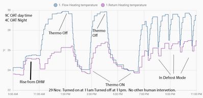

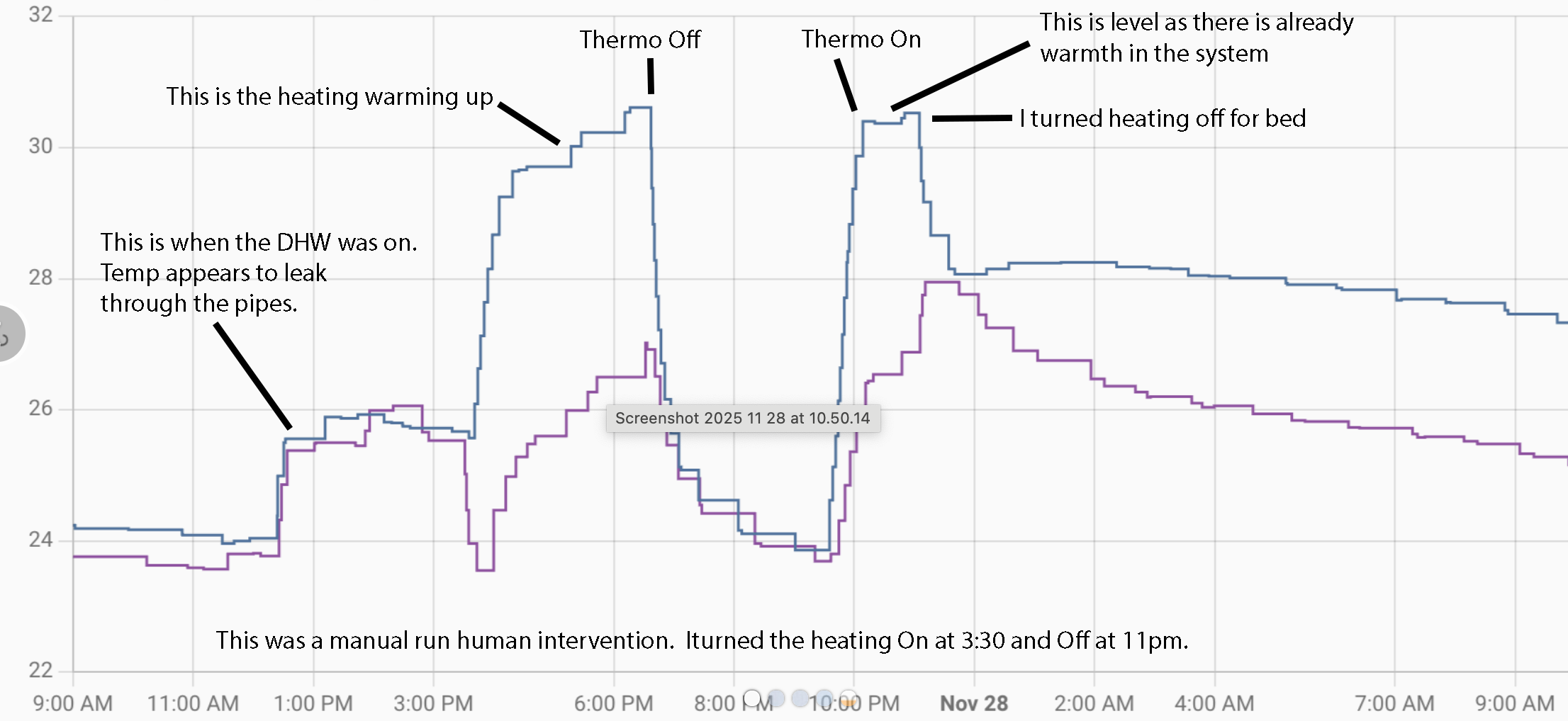

I have annotated the image to show what was going on.  This was a manual run because we had 13C outside.  Hope this helps.

Posts: 5629
Posted by: @trebor12345
Ah that makes sense.  I think 'off' is actually 'setback' rather than truly off, which is clearly what has happened, a 3C setback in the target flow temperature.
So are we back to suspecting defrosts causing a drop in temperature, or do you usually turn the heating off for bed?

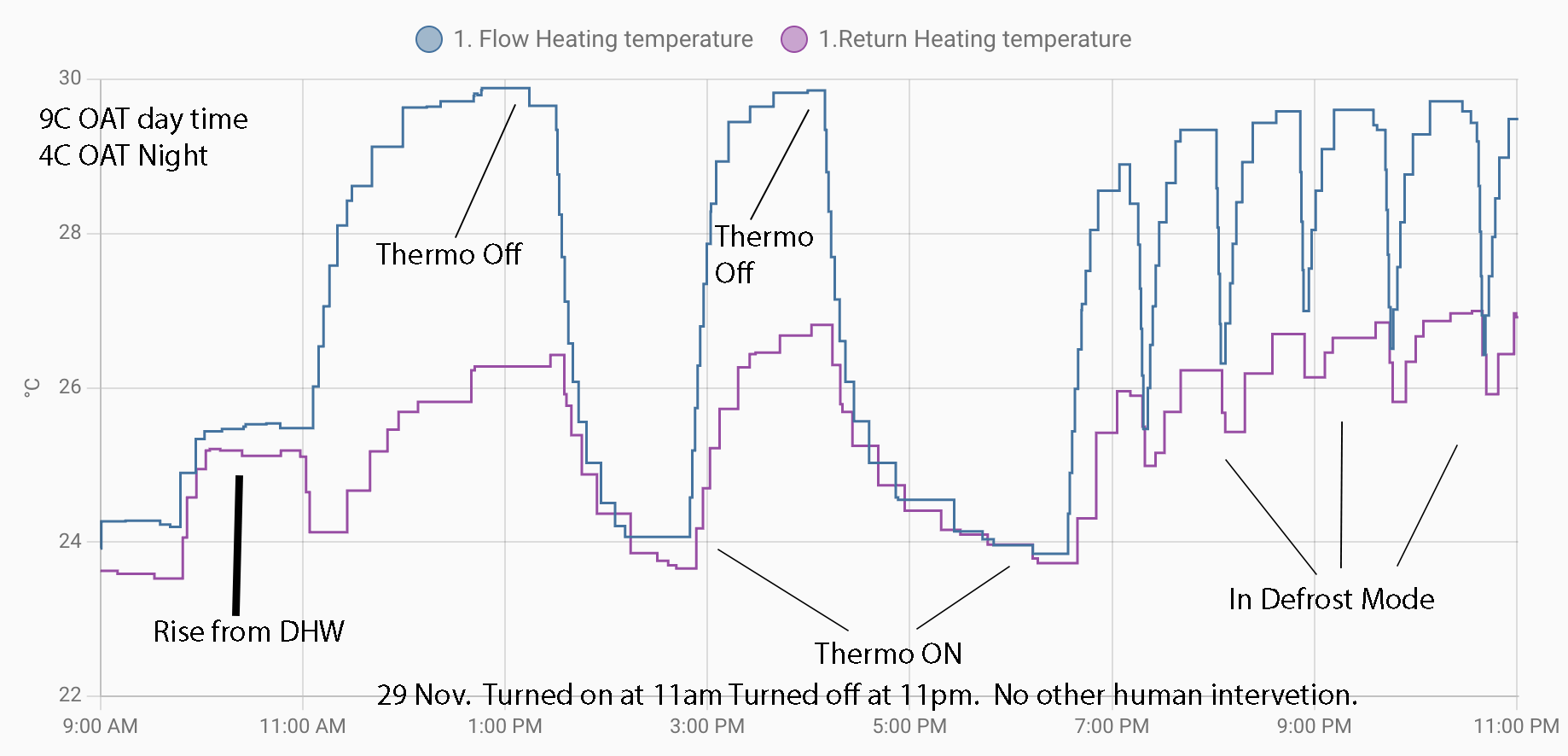

In mild conditions, yes I turn the heating off.  This is done by putting the Heatmiser thermostat on the wall into the off position.  So there is absolutely no demand for any heat.
I have even taken to turn the indoor unit into the OFF position at bed time.  Which it is now. Circuit 1 is the heating.
When its cold (below 6 ish) I leave the heating on all night.
I have no setbacks.
Yes I am 100% positive that the defrosts cause the drop in temperature.

Posts: 5629
OK noted, although I dont think any of the charts posted show this.  This one definitely seems like human intervention not defrost because of when the rise and fall in flow temp occurs relative to onset of defrost.
However I dont think it is now crucial.  I think there is enough evidence that nothing is critically broken to proceed to try to get it working on Weather compensation, which should, if you can get the parameters right, mean you can mostly just forget about it.
