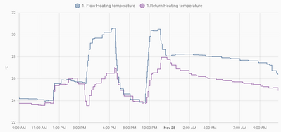

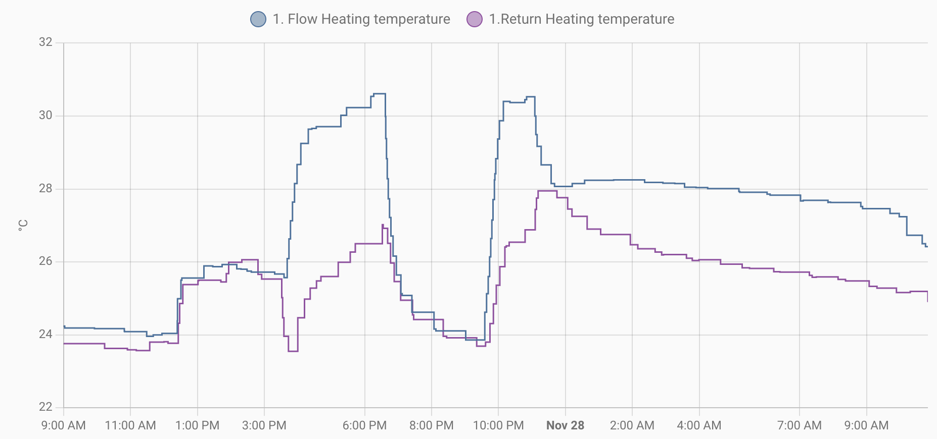

This yesterdays run.  In manual mode, so I turned the heating off and on.  It was 13C OAT yesterday.  But the off cycle between 6 and 10 was the Thermo Off cycle.

Posts: 5629
@trebor12345
Well that is interesting.  Note that even without defrost the FT fell to ~28 overnight.
I now suspect you have a setback operational.  What I dont understand is the slow tail off, but maybe this is just the control system and the slab slowly cooling.
Its even possible that the setback alone is the cause of the observed reduction in FT during defrost, and that night shift isnt making a difference to this.  I think I would leave night shift on for now, but cancel the setback.  That way we can work out whats happening for definite.

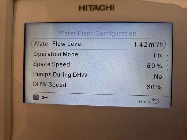

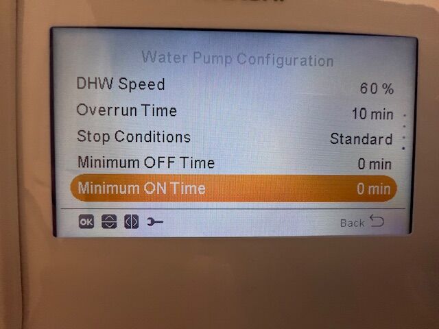

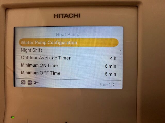

I have been in the system and done some images of what I found.  Not the same as your details. I didn't find an ECO setting.
IMG 0459
IMG 0458
IMG 0457

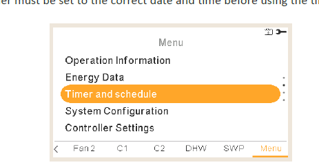

Posts: 5629
Posted by: @trebor12345
Setback is in the user menu - time clock/schedule or similar.

Posts: 5629
Pages 56 on in the manual.  Somewhere you will find a heating schedule.  You may not find an 'eco' setting, but setting the pump 'off' probably just sets back the FT.
