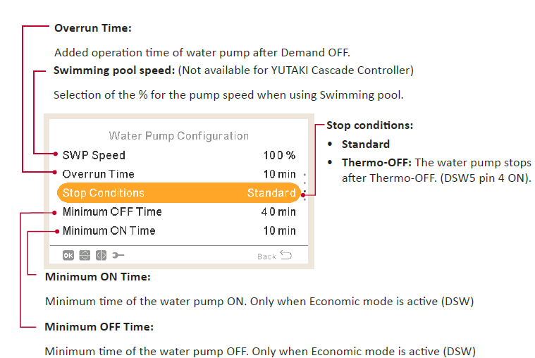

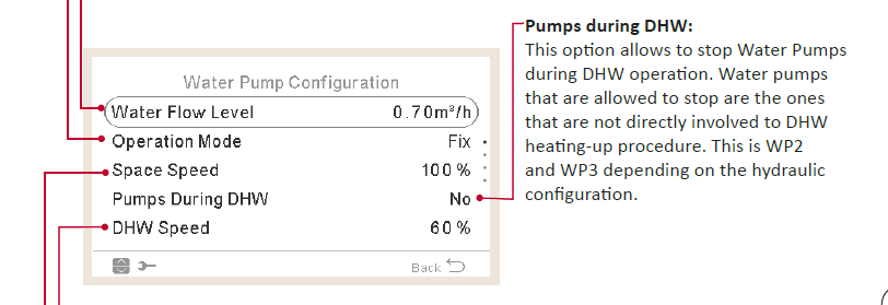

The 4C thermal off rule is very likely going to interfere when its warm outside, less so when its cold outside.  I am not sure how to deal with this TBH. The whole thermo off thing isnt well explained  Here is what it says in the controller manual

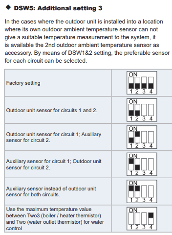

And here is the corresponding bit in the IDU manual.
Thats  about as clear as mud.  What can you add to this from what hitachi told you?  I think it may be necessary to revert to 'standard conditions' and then control the cycling using the facilities on the controller to specify min on and min off times!  Alternatively it may be that the FT at any temp will have to be higher than it ideally would be, and compensated for by setting the system to run part time.  I wouldn't change this yet however, although I might take a picture of DSW5.  Can you anyway post what the settings are currently on the screen above and also the two screens at the end of the post?

It’s a long time since I’ve looked at the manual but I thought I remember Thermo off just controlling any secondary circulation pumps?
I’ve spent hundreds of hours in those Hitachi config menus - happy to help if I can
