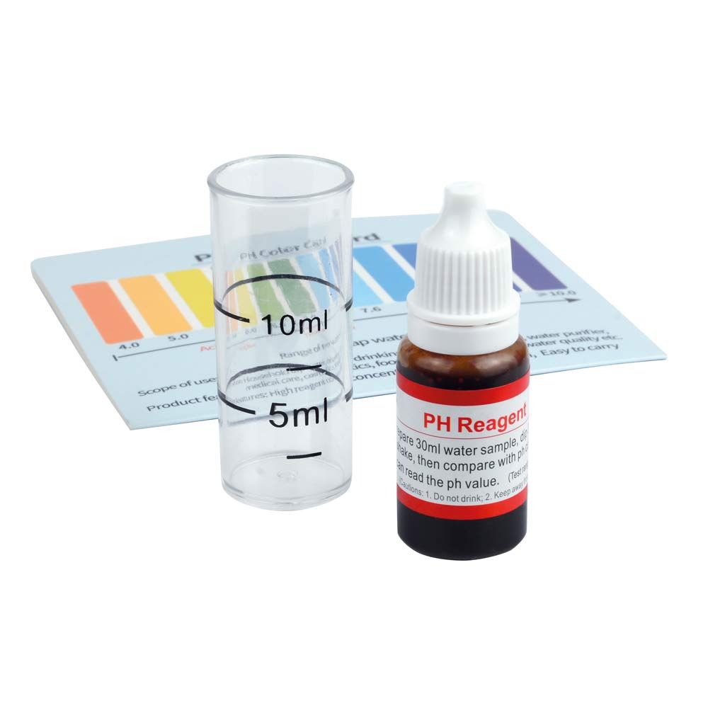

Posted by: @iantelescopeWhere did you get the water conductivity meter and the Ph meter ?
pH - following a recommendation, using drops
I have unit designed to fitted permanently, but using as a temporary unit. It measures conductivity and TDS ppm
