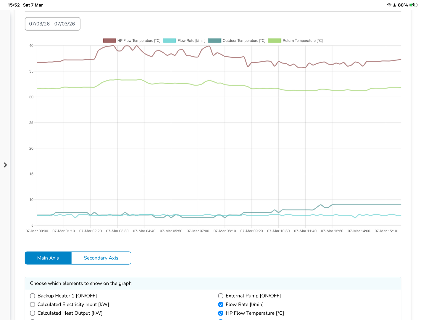

Further to my previous posting, this plot shows today’s OAT, Flow and Return temperatures and Flow Rate. Regards, Toodles.
@toodles It was i that misunderstood.
But, still, when I look at the data from your system, I’m struggling to see any correlation between outside air temp and flow temperature. No evidence of cause and effect, but equally possible is that on that day there wasn’t a sufficiently large change in air temperature to initiate a change in flow temp.
I know that with mine, if I’m standing near it, I do hear relatively frequent changes in tone, small adjustments, which suggests that something is being varied. I had always assumed it was the speed of the compressor motor being tweaked up and down.
