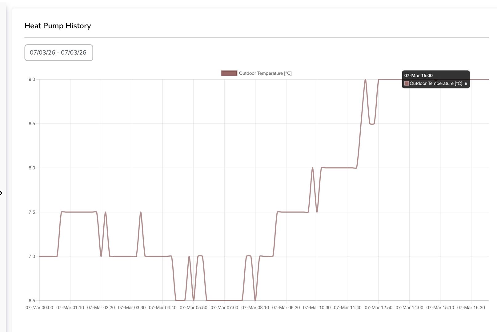

@papahuhu Here is a more detailed plot of the OAT on its’ own for today; not much change there. Regards, Toodles.

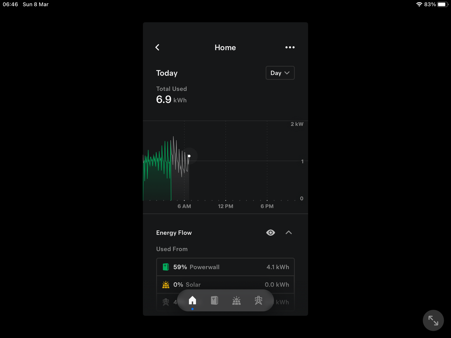

Posts: 444
@toodles
out of interest I took a screenshot, first thing before the variable house loads started,  of the PW home demand. You can clearly see the small variations in power demand that I can hear. Does your heat pump not do the same thing please?

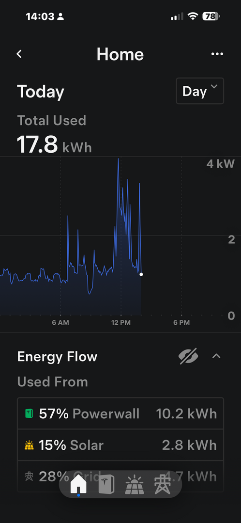

Posts: 3075
@papahuhu I don’t think I could make any such comparison as I have so many factors in the background domestic load, even if I could see the variations. We have a NAS, a network system with two wifi repeaters, a ‘fridge, a ‘fridge/freezer plus numerous ‘always on’ items around the house. Everyone of the non-constant drain devices will cause variations in the readings of course. Hand on heart, I don’t think I could detect any heat pump load variations if I tried! Regards, Toodles.
IMG 6807
(@papahuhu)
Honorable Member Member
Posts: 444
@toodles We also have a base load of about 300W too. But fundamentally they are different profiles, mine is slightly oscillating up and down, but not cycling. I don’t know if it’s good or bad nor what is causing the signal for that to happen. It does the same thing in very cold weather, so it isn’t because it has reached its minimum output.
