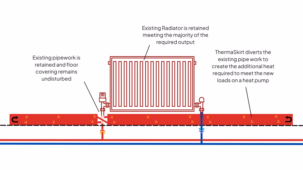

When DiscreteHeat analysed years of their own heat-loss data, they found something surprising: “Over 80% of existing radiators were within about 30% of the required output for low-temperature systems,” Wadsworth told us. “Once we saw that, it became clear that full-scale radiator replacement is often unnecessary. We don’t need to tear out what’s there, we just need to supplement it.”
This insight led to the development of Add2Rad, not as a product but as a methodology, a systematic, minimal-disruption approach to strengthening emitter capacity using small, strategic additions rather than wholesale change.
"For customers that want to eliminate radiators completely, the ThermaSkirt still provides that option. But the Add2Rad approach will be the fastest, least disruptive and often lowest cost way to make an existing properties emitters optimised for heat pumps"

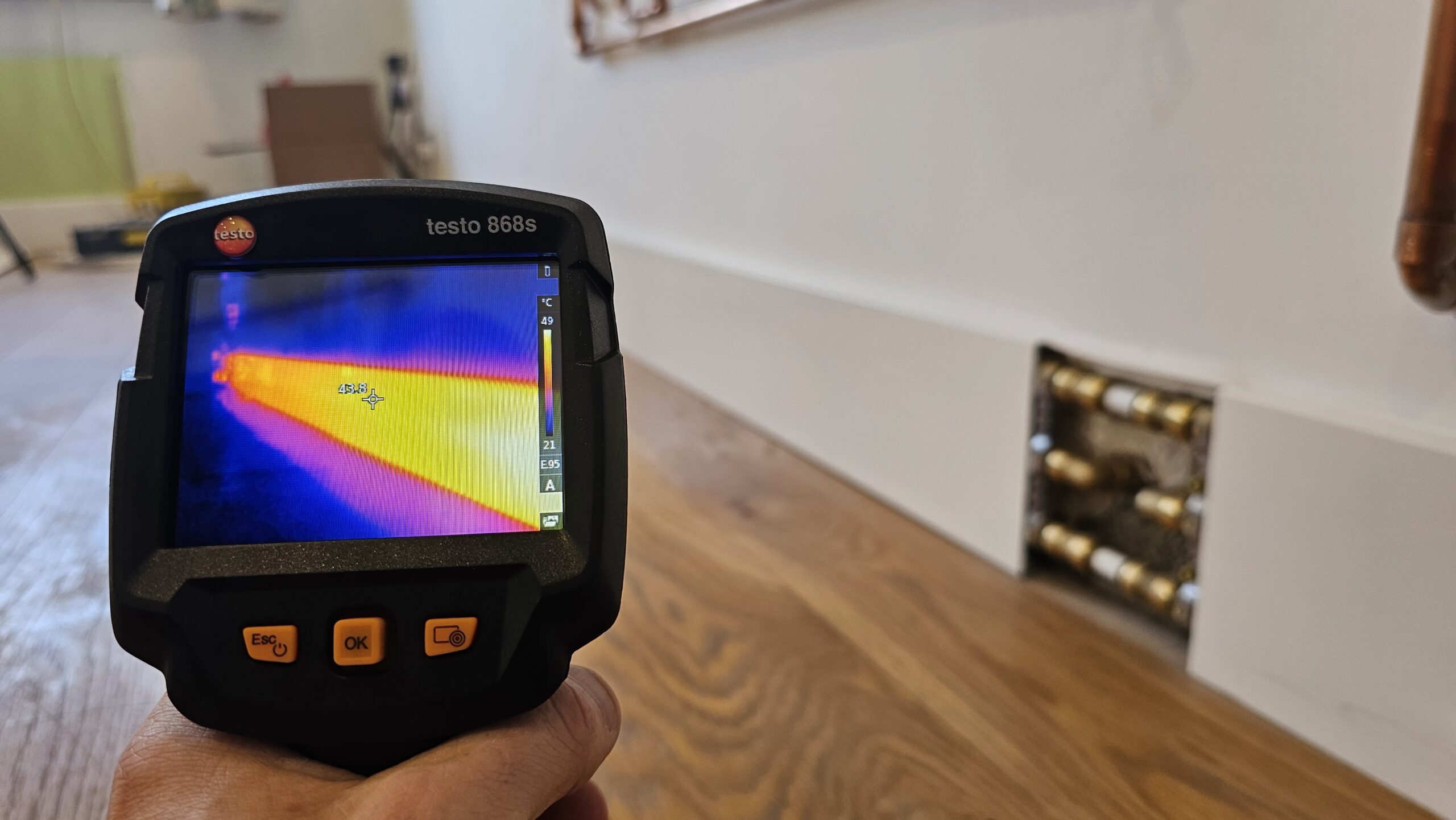

Add2Rad connects a short run of ThermaSkirt aluminium skirting heating in series with the existing radiator. A simple tee off the flow pipe before the TRV allows the ThermaSkirt profile to act as an extension of the radiator, boosting its output at low temperatures without altering the radiator itself.
In practice, 2-4 metres of discreet aluminium skirting typically supplies the missing wattage.

Super niche. Bigger rad is less labour, less connections, less upheaval, and less money.
The idea (and at least one similar product) has been around for a while, I even considered it for one awkward room when I did my upgrade a year ago.
However the output per linear metre simply didn't add enough in my case unless I went all around the room which wasn't realistically possible due to doorways. I suspect such practical problems will frustrate it's use in many cases and as @dtard says larger rads are cheap and easy to install. However the more options the better, with 20m houses to do in in the UK alone even a tiny percentage may be a worthwhile market.

If it is combined with the BUS and they make it all good, it could be a way to replace tired skirting..
The dream would be if someone like Octopus would take care of it...
There's many homes that would be quite a disruption for, looks good in photos and sounds good (and is, we've used them) but old skirting takes some removal and if an older prop then the character goes. I've found fan coils have often been a better and simpler install, rads are recyclable at scrap yards, we just took 23 with a weight of 680kg for ££. Fan coils are slightly more than an equivalent rad but only around 25% of the cost. All options should be considered though, as one item does not always fit all.
