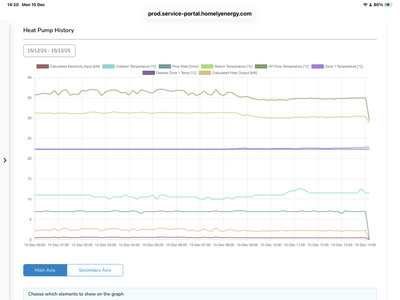

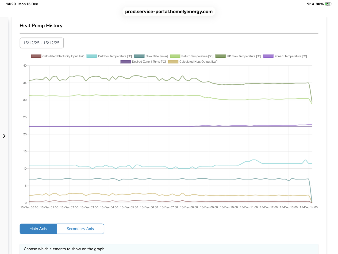

Posts: 3089
@papahuhu I am attaching the Homely report for today’s performance so far; the heat pump has been gently supplying heat (at ~400-500 watts energy consumption) with hardly a break since midnight. Regards, Toodles.

Posts: 3089
@papahuhu Likewise, my heat pumps is much smaller and the maximum draw I have seen is ~2.5 kW though most of the time it is ~1 kW or lower. I’m on Cosy and with 27 kWh’s of Powerwall storage, can ride through the more expensive 16 hours of the day comfortably. Regards, Toodles.

@toodles
that’s perfect, nothing like mine. Today mine will have started and stopped 3 times every hour. I can tell from the Tesla app that it ramps up to 4kW and back down to zero in less than 15 minutes, then does nothing for 5 minutes and then cycles again. Grrrr.
I watched the installation team install the homely correctly, I don’t know why it’s playing up. I’ll give the installer a few more weeks to sort it and if not I’ll go to their certification body to initiate a formal complaint and investigation. It’s a shame, the mechanical install was perfect, I could fault them, it’s just something is wrong somewhere with the controls.
thanks for posting it, I still can’t get mine.
