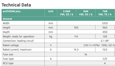

I am having my existing heat pump changed to a Vaillant (another story).  The question of fuse type has come up in conversations.  According to the Vaillant spec I need this:
Screenshot 2026 02 20 at 16.20.25

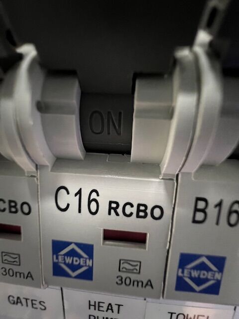

The current fuse I have is this:
IMG 0507
Is this the right one?

 This looks OK, am I right?

It's not marked if it is the required c or d curve. If it is b curve, it may cause nuisance tripping more easily. The electrician should be able to confirm and get it swapped if it is not the recommended one. But as far as I am aware, a b curve is more sensitive and so would still trip in any situation it would be expected to (for safety).

The photos show a 16A, C curve, type A RCBO.
A RCBO combines the function of an RCD and MCB.
The RCD component of the breaker is Type A, 30mA.
The MCB component is 16A C curve.
C or D curve breakers are often required when equipment has high inrush currents (typically seen in motors) that can result in nuisance tripping of B curve breakers.
Depending on your supply type fault protection may be provided by the the MCB portion of the breaker, or may be relying on the RCD component for both fault and additional protection.

Thanks for confirming. I should have suspected "C16" (instead of "B16") would mean C curve on Lewden´s! 🤭 This Vaillant requires at least C, so all good.

It would appear that the installer has sent me an out of date spec document on the Vaillant heat pump.  It now appears that I require a type B.
Screenshot 2026 02 23 at 14.15.23
This means an additional consumer board needs to be fitted along with this new breaker.
I suppose electricians prefer to have a consumer unit of the same brand as the RCBO. But if an EICR is carried out, if a different brand was used, this is rated amber, not red.
@transparent may be able to advise on what could work, essentially it seems to need to be 16Amp type A, B curve. Screwfix seems to have a wide range of Lewden
If Vaillant is that prescriptive about the type of RCD/RCBO, it is a shame they do not incorporate it into the appliance..

The document refers to an RCD, which means the Type-A or Type-B refers to whether it will trip due to the level of the DC component in the leakage current.
Type B is a fair bit more expensive, and normally only contemplated for supplying an EV charger.
RCD type
@batpred then refers to an RCBO, which is a different device anyway, and not suggested by the Vaillant literature.
Either the heat-pump will be on a circuit fed from an RCD and an MCB, or else it will be fed by an RCBO.
Type B on an RCD, is totally different to 'curve B' (or curve-C) on an MCB.
I've just re-read what you've both been writing above, and you've referred to those concepts inconsistently.
I'd suggest start again, and forget what you've already been trying to clarify to each other.
From this table, I understand the following is needed in sequence to feed the heatpump:
  • the fuse/mcb is characteristic C - so C curve
  • the rcd is type B
An RCBO performs both functions.
The board you have includes several RCBOs and I assume all are being protected by a single B curve 40A MCB.
The heatpump cannot be fed by the same MCB. It needs a separate C curve MCB. But it also needs RCD type B.
If the MCB could be changed by a C curve one (and not invalidate manufacturers warranty, etc), perhaps you could avoid a separate Consumer unit.
But the main thing to focus is that a Type B RCD is needed. Wylex may be is a good brand that supplies them. It makes sense your electrician is suggesting they would use a separate CU (even if sometimes it could be avoided, the electrician that will sign it off ultimately decides).
