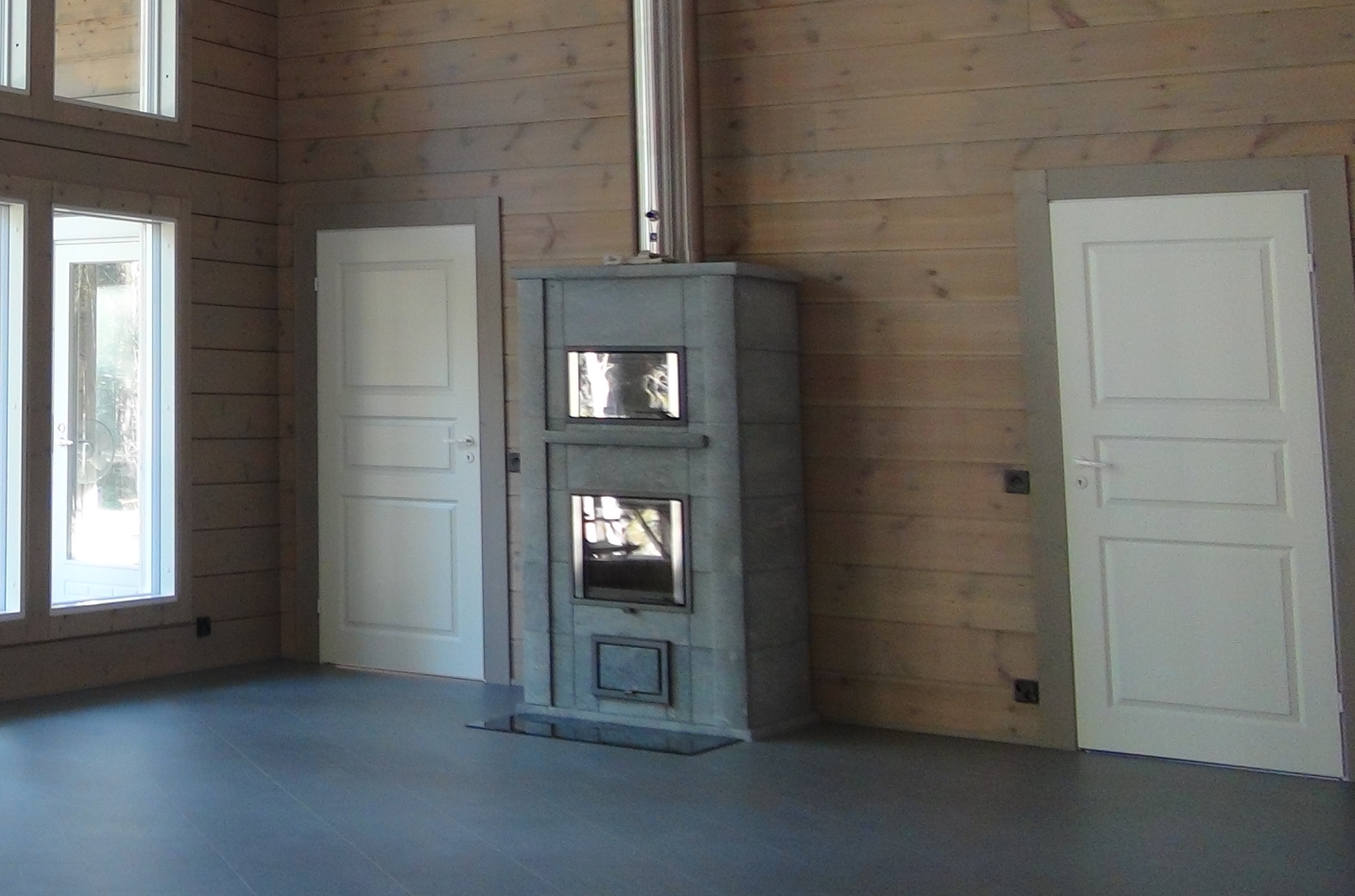

Underfloor hydronic, powered by both the heat pump and a wood gasification burner (both coupled to a 3000L thermal store). In addition, I have a masonry fireplace:
masonry
