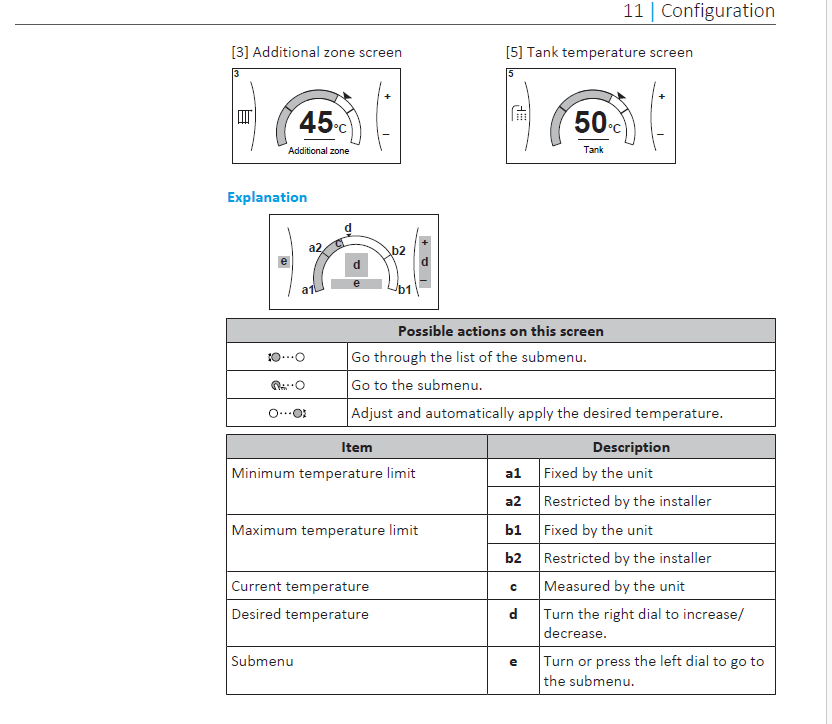

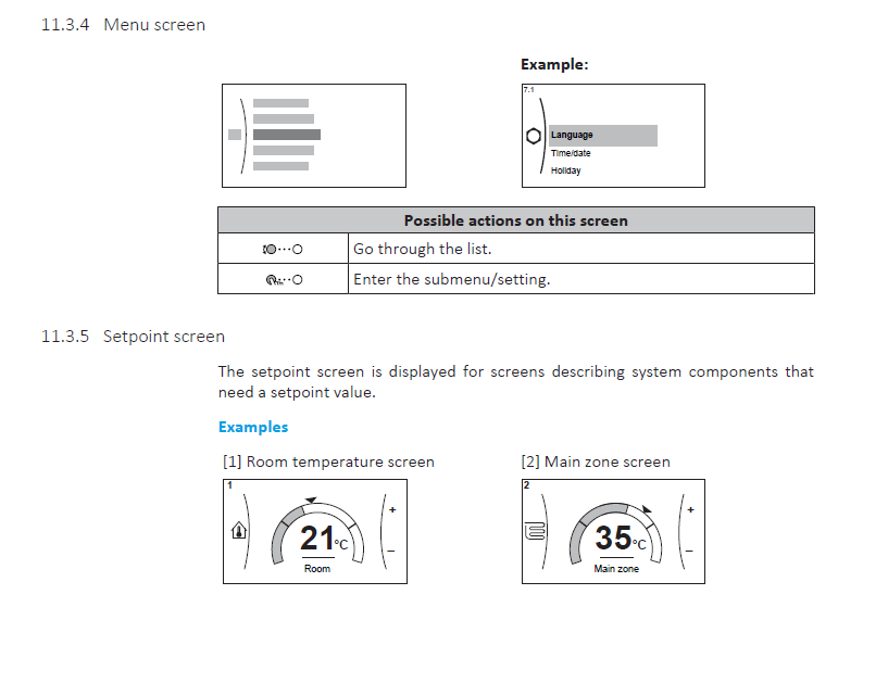

The 50C limitation may well be an installer setting, not inherent to the heat pump, and if it is backup heater wont help because it will be governed by the same limit. Here are a couple of screenshots from the Daikin LT (low temperature) Heatpump manual from which you can see that the concept of installer limits exist (as with many heat pumps). You probably have a different heat pump but the control concepts will be near identical. Have a look through the installation manual for your heat pump if you can find it online!
