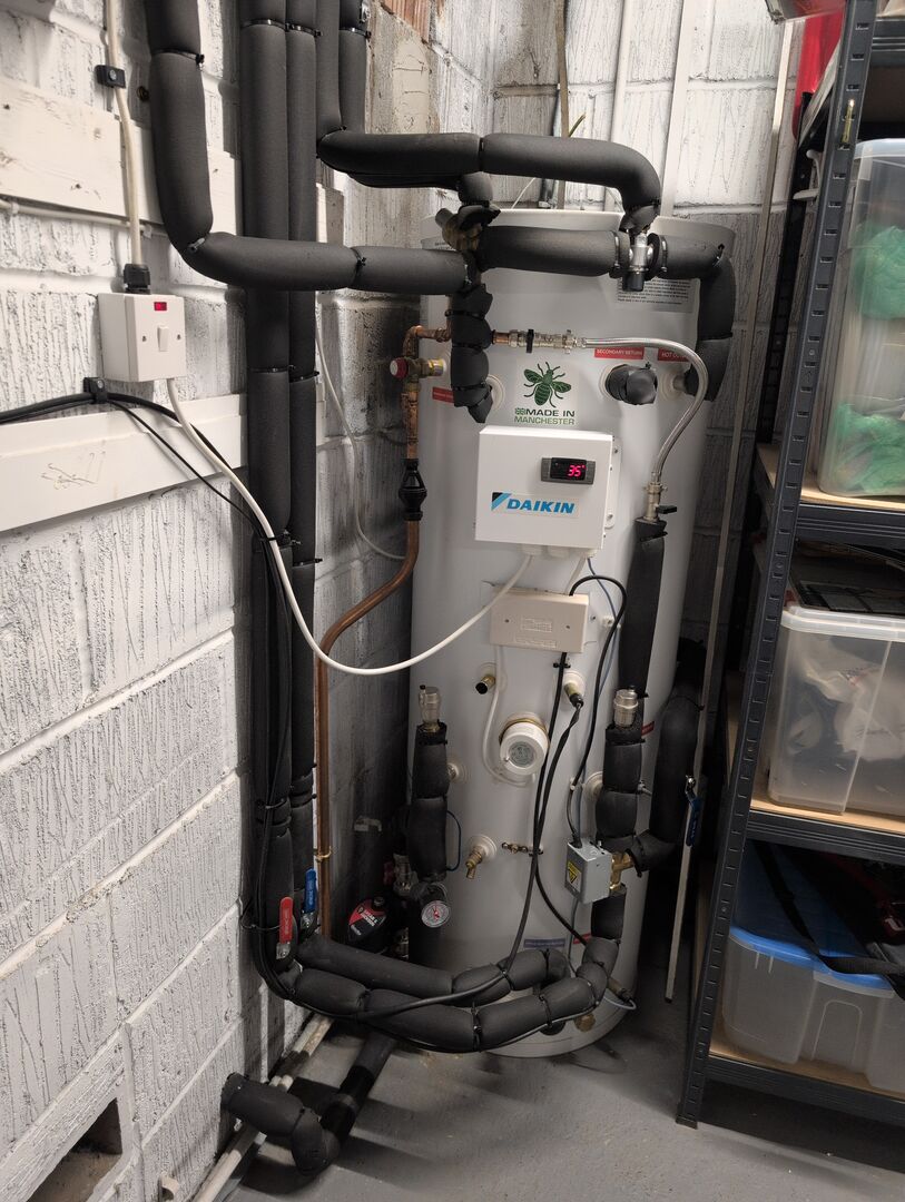

@jamespa thank you, I'll start recording these, I can see them on the Onecta App. In the heat loss document it gives LWT range 35-50C, minimum ambient temperature -8.4C, I don't see anything more detailed than that, not sure if I should? I have a 180litre preplumbed Daikin cylinder which I think includes a buffer.
Are you able to post a photo of that 180-litre cylinder please @mairia ?
We can soon work out what it's meant to be doing once we see how the pipework is arranged around it.

Posted by: @mairia@transparent apologies I missed your post. This is a photo of the cylinder.
The literature online does indeed suggest a 20l buffer tank 'which can also be used for hydraulic separation'. This suggests that Daikin are not saying it must be used for hydraulic separation, it would help to know if yours is which comes back to determining how it is connected.
I cant quite tell how the plumbing is connected and thus cant decide whether or not there is a buffer tank. Is there a water pump in the vicinity? Do you know which of the pipes shown are the feed/ return to the heat pump and where are the emitters connected in this picture. Perhaps @transparent can see something I cant!

@jamespa I don't see anything that would help me know what pipework goes where. I don't see a water pump anywhere, and actually have a vague memory that the installer may have said the buffer tank wouldn't be used for hydraulic separation, but I'm not certain. Monitoring on the Onecta looks overall ok to me with LWT being what I would expect for outside temperature looking at the heat curve. Although sometimes LWT is maybe 1 or 2 degrees lower than I would expect. I don't know if there's any way to check if the DHW is heating at those times, would the LWT reflect that? I did get one reading of outside temperature 10 and LWT 49! I didn't know what to make of that. I'll try to be a bit more organised at monitoring as I've just been checking it randomly.

Posted by: @mairiaI don't see a water pump anywhere, and actually have a vague memory that the installer may have said the buffer tank wouldn't be used for hydraulic separation, but I'm not certain.
If there is no water pump visible either there is no buffer or its actually plumbed as a 2 port volumiser. This would be good news. Please let us know if you find one!
