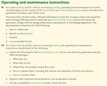

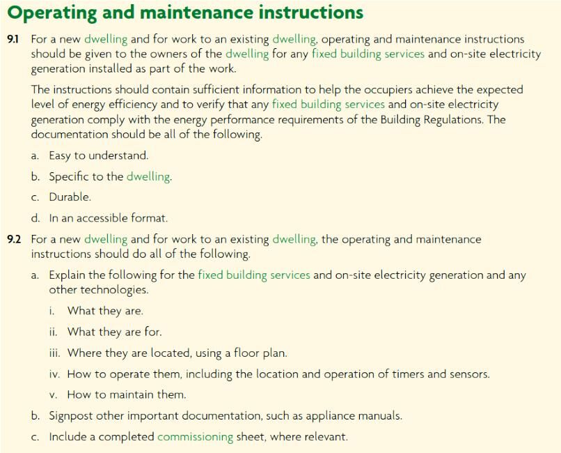

Posted by: @mairiaI did pore over all the documentation I have, and was definitely not given a copy of the heat loss calculation.
That's a failure to comply with Part-L of the Building Regulations.
The householder must receive all relevant documentation, and it must be site specific.
You should also therefore have a full system diagram of what's actually installed in your home,
plus instructions on how to operate and maintain the system so as to minimise the amount of energy (electricity) which is used.
Note too the requirement for a written Commissioning document.
As each house is different, the system components will vary.
Thus the Installer has to construct a commissioning schedule for your specific property.
That will necessarily include a final section in which the system is configured to be optimally efficient.
It isn't possible to do that in a few minutes as a tick-box exercise.
