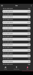

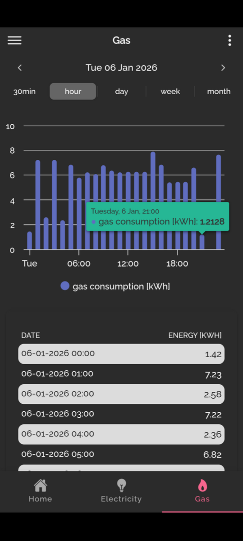

Our heat loss was calculated at 6.2kw @ -2 45c.

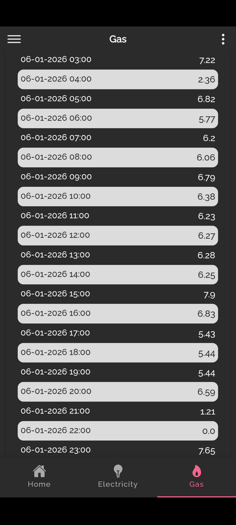

Below is our gas usage for the coldest day Tuesday 6th Jan, which ranged between -8c and +4c
This looks like our heat loss calculation was bang on (to me).
Have I interpreted the gas usage right from the bright app?
Thanks.
Posted by: @bashHave I interpreted the gas usage right from the bright app?
In a word yes.
Measurements based on a single day should be treated with extreme caution, houses take a long time to react. However as a general indication this is likely to be good.
Like you I turned down my gas boiler before getting a heat pump and like you it improved comfort. Unfortunately the way boilers are typically run in the UK increases cost by about 10% and reduces comfort. Madness!
