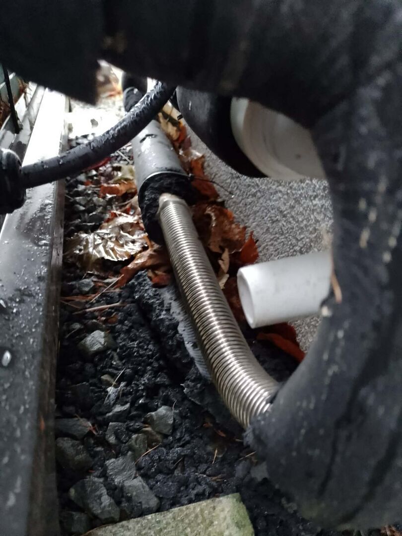

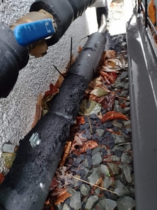

Hi - noticed the exterior pipe insulation around my air source heat pump seems to be crumbling exposing some of the pipe work - any advice on what & where to get replacement insulation. Cheers

@plummersknowe, yeah, that's pretty awful. Completely the wrong stuff to use, and I assume (if it's what I think it is) that it's porous too. The best product on the market that most top heat pump installers recommend is Primary Pro. Where are you based @plummersknowe?

Plus the pipe is in contact with the ground so it's a cold/moisture bridge and needs to be lifted or at least an air gap created underneath.
HI few issues there, but let's look at the insulation in general
The insulation looks like is been eaten away or eaten, and also deteriorated.
If the insulation were off the ground more, this could have helped
The insulation used has a low water diffusion resistance, and allso has not been sealed on all joints and all fittings ( you can see them exposed)
This will allow moisture and water to be absorbed, and so seriously reduce insulation efficiency
also the clips are around the pipework, and then the insulation has been fitted, so leaving gaps where moisture and water can get in

Also keeping the flexi hose as straight at possibel help to take the stress out of the flexi connections and makes it easy to insulate and seal

Thanks for the heads-up, we’ve recently moved into the house, the house was built in 2021 along with installation of the ASHP system - I’ve had an heat pump engineer out to service the heat pump and all good however he mentioned the poor insulation job around the exterior pipe work. Will check out the web site you mentioned and see what needs to be done.
