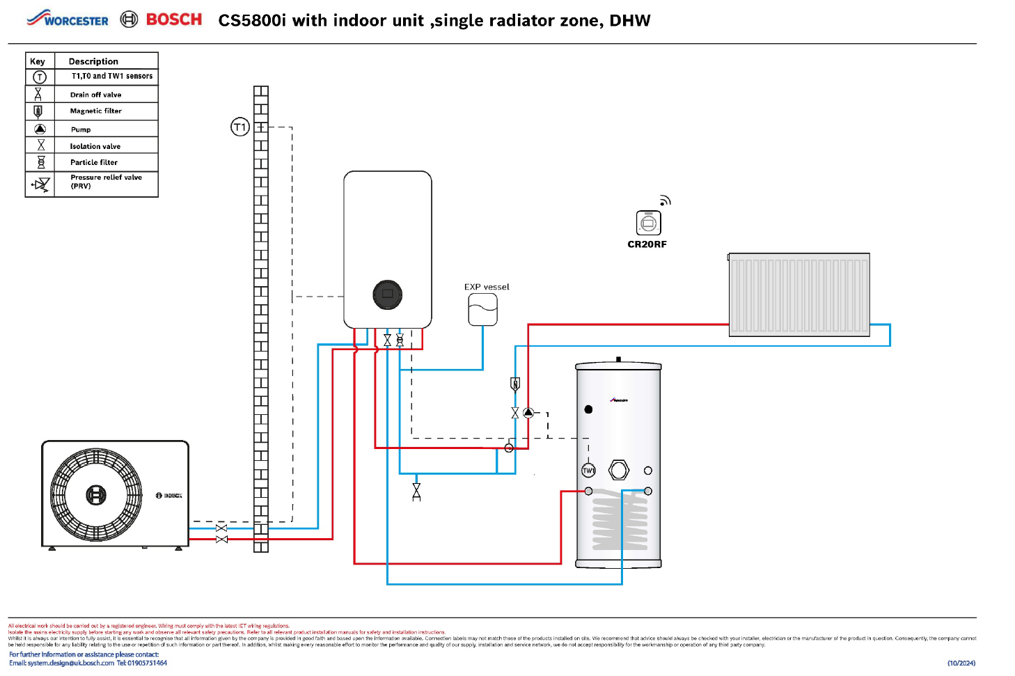

Yes, thanks. Bosch 5800 is here. My point is about the product naming. Essentially a 7kw Vaillant is acceptable to installers for our home but a Bosch engineer did not think the Bosch 7kw would be powerful enough (and I said I would need 6-7kw).
They provided a new design using the 5800. It does not use a buffer but has a wall unit which I am not clear if it isolates the rad flow from the ashp flow. My guess is that it does, since it needs an additional pump for the rads.
Below is the table with the bill of materials:
It might be a 'split' rather than a monobloc.  That's where some of the functions are put in a separate box.  There are various ways to split but the most common are hydrosplit, where all the refrigerant bits plus the heat exchanger are outside, but the rest of the hydraulics are inside, and a split where the compressor and heat exchanger are inside in addition.  The diagram suggests it might be a hydrosplit in which case there shouldn't be a water pump in the odu.
(@batpred)
Posts: 1229
@jamespa
Yes, it is a hydrosplit (the pump is not in the ODU but in the indoors unit).
And the idu seems to have a heat exchanger.
Posts: 5625
Posted by: @batpred
That's odd and concerning. Unless the pipework between odu and idu is refrigerant not water then that suggests system separation with all that goes with it
(@batpred)
Posts: 1229
Posted by: @batpred
The heat exchanger is my guess, as I cannot see what else could allow a third party pump in the rad circuit.
Posts: 5625
Posted by: @batpred
Agreed unless the bosch has no water pump included in the casing, like mitsubishi heat pumps (and some boilers) I believe

Posts: 5625
The installer guide here  suggests that the ODU has no pump and the IDU has a pump but, so far as I can see, no heat exchanger.   So its just like a monobloc but split over two modules
Several heat pump manufacturers split this way, a variety of packaging options makes sense to fit a variety of available spaces.  Its just a way of differentiating.

Posts: 5625
Posted by: @batpred
Differentiation makes sense, but so would including the rad circulation pump...
I guess it depends on whether they can pack it into the space without creating another case size.  Also leaving the water pump out gives the installer the option to fit a more powerful one in marginal cases.  Horses for courses!
