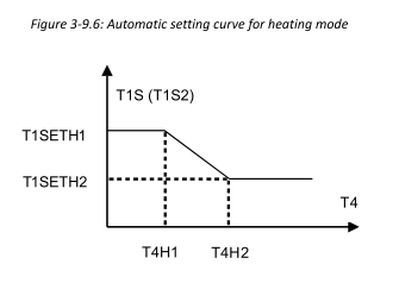

To expand on what @benson has said about the lower end of the WCC, thee key point is the curve flat lines either side of the end points:
T1SETH1 and T1SETH2 are the LWT (flow) temps we set, T4H1 and T4H2 the OAT. Either side of the slope, which sits between the end points we set, the 'curve' flat lines. If the OAT goes below T4H1, the LWT doesn't get any hotter. By moving T4H1 a bit lower, the LWT continues to rise to that lower point, and only then flat lines. I have at times set my T4H1 to -4, but it is currently -2°C.

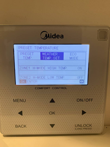

Quick question I read another old post from @curlyKatie who was also setting up WC curve. on a Midea. She had this screen
- I have similar but the Weather temp set is blank - I assume this is correct ?
I have checked my W_O PLATE W-OUTLET TEMP if LWT (flow) and TW_I W-INLET TEMP is RWT (return) - both are 32C which sounds about right as it is now 8C outside. Also put a temperature gage on a rad - 30C which is again I think about right.
Slight fly in the ointment our Room Temperature is now 23C (our hallway - location of the Midea wall unit ) was open to our kitchen/Diner - had cooker and oven on for an hour and three people so this probably raised the ambient temperature a degree).
Posted by: @stevetI have similar but the Weather temp set is blank - I assume this is correct ?
It's not actually 'blank' and you have 'ZONE 1 H-MODE HIGH TEMP' (Midea-speak for your main circuit) set to ON as it should be. When it was first set to ON, it should have taken you to the curve selection window, and the one you want is curve 9, which is the custom curve where we set the endpoints.

Sorry that was a screenshot of @curlyKatie - mine has all the Weather Mode Settings to OFF - there are four settings
Posted by: @stevetmine has all the Weather Mode Settings to OFF
You need to set the one shown in the photo you posted to ON, you will then get to choose which weather compensation curve (1-9), choose 9, that is the custom curve, the one on which we set the end points, and you are done. You may or may not need to turn the heating back on after doing that, sometimes changing settings turns the heating off. Check the main home screen to see whether it is on or off.
Posted by: @cathoderayPosted by: @stevetmine has all the Weather Mode Settings to OFF
Thanks, sorry for daft questions. I now have this set to ON as per screenshot and selected curve (9). What as the Midea been doing for the last 3/4 days, RADs and power consumption and house are cooler (now 20-21C). Was it doing anything with my 28/14 and 50/-4 settings? I followed the instructions from "Grahams Heat Pump Channel" on youtube, he talks through the curve settings, but does not mention the first bit.
