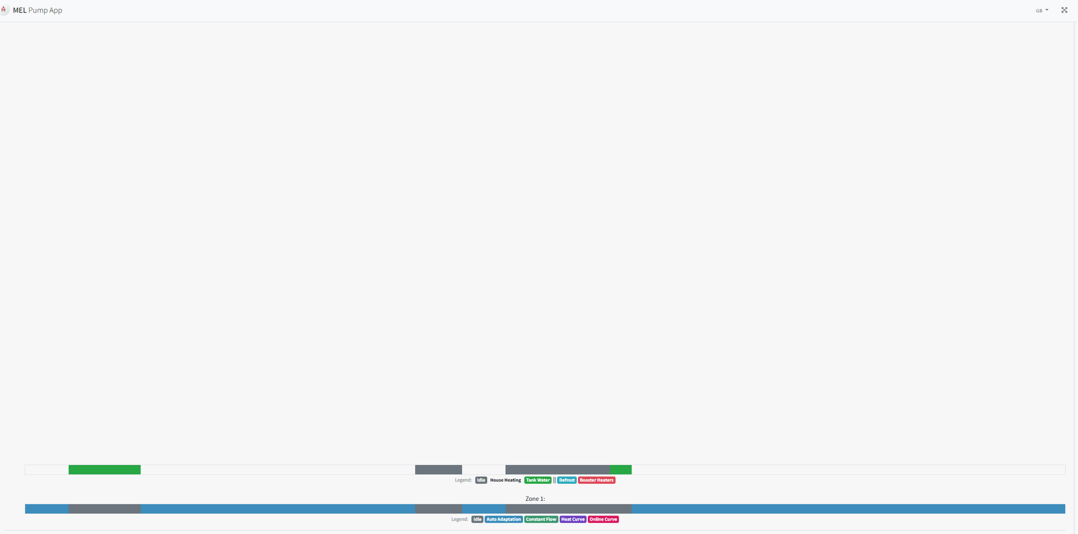

Anyone else having issues getting Melpump to display their 'interactive' charts via the Share as URL option?
I'm just getting a blank page, other than for the summary coloured sections at the bottom.  I was hoping to use one in a forum reply, but it would be of no use currently.

(@f1p)
Posts: 132
Your energy: 12 kWh
Thanks for reporting, there is a known issue following a security adjustment
 F1p
(@f1p)
Posts: 132
Your energy: 12 kWh
Posted by: @f1p
It is fixed
