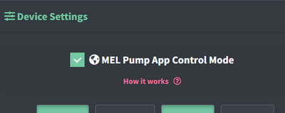

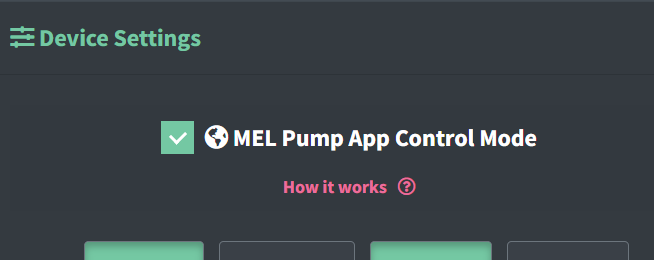

The final part is how the MELPump CN105 Adapter works, because enabling MELPump App Control Mode (also known as Server Control Mode) will ignore all FTC schedules, thus preventing scheduling conflicts
