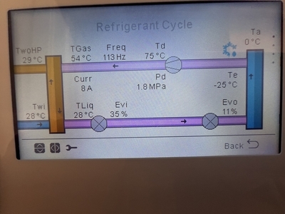

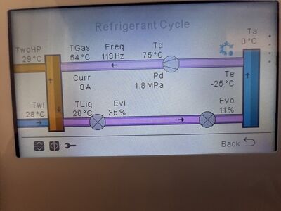

I had a not dissimilar fault with my Vaillant albeit I did get a (pretty useless) fault code. Diagnosis was made easier by a function called 'live view' which is essentially a stream of consciousness display telling you what the heat pump is currently doing and a wat of viewing current values of certain sensors. If yours has something similar it might be worth watching it while you trigger a DHW cycle, or create the conditions that should trigger a DHW cycle.
I had the Hitachi Yutaki 7kw split ASHP system. As James said, look for the live view settings in the controller might give you a clue as to what is going on. I did find it helpful in understanding what was going on.

Hi @jamespa , @trebor12345 ,
Thank you both for the reply.
Can you clarify what you mean by "live view settings"? On the System Controller itself, I already have a live sensor readout screen (TDHW, SDHW, TSUP, TRET, S1, SSUP, etc.) which I've been watching closely - that's how I know SDHW stays at 0 even when TDHW is well below the DHW setpoint. If you mean something different/more detailed than that, I'd love to know where to find it.
@trebor12345 - is the "Refrigerant Cycle" screen you posted (TGas, Freq, Td, Curr, Pd, Te, Twi, TLiq, Evi, Evo etc.) what you meant by live view? Is that on the outdoor unit's own display, or accessed through the System Controller / a service tool? I hadn't seen that screen before - happy to look at it during a stall if it's accessible to me, but not sure yet how to read it or what would indicate a problem versus normal operation.
