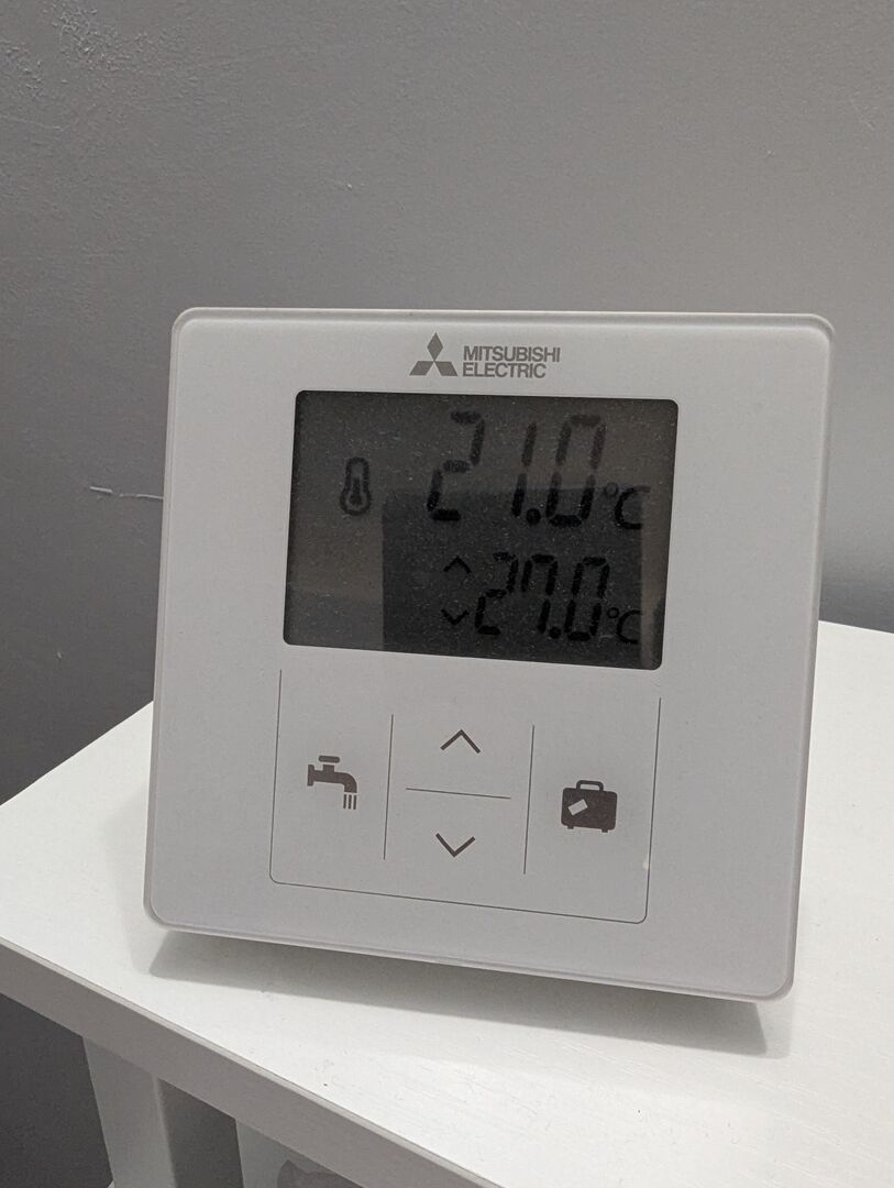

@majordennisbloodnok It's one of these, I believe.

Posts: 224
@davidalgarve That's what mine is currently displaying from the living room, with the system operating on a weather curve currently.  I can amend the target temperature, but the only requirement currently is to set it above the target temperature to create an ongoing call for heat, hence 27°C does the job in that regard.
