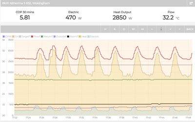

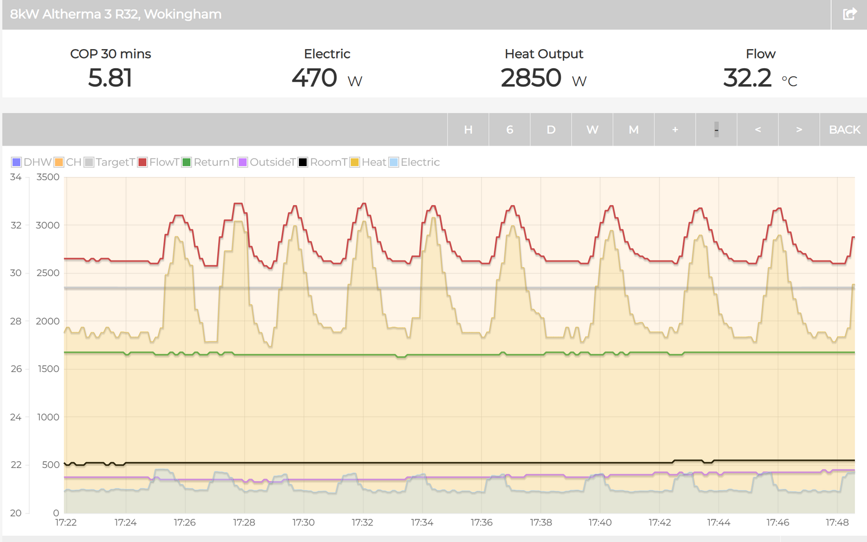

Having had a trawl through OpenEnergyMonitor I found a useful page that gives some real time data around the electricity consumption fluctuating that may be of interest.
If you click on the chart icon to the right of "Approved you can see the detail. In all cases (bar one which I am very interested in!) show the same micro cycling (not full cycling) of the power, which is the same behaviour as ours. If you click on the picture it will take you to the page.

Here the heat pump runs continuously and generates power, which manifests as DeltaT between flow and return, and is also displayed as "Heat" power in W.
So it is not cycling, which usually means the compressor stops and starts.
It seems the heat pump's power levels are discrete and it is switching between ~2kW and ~3kW when the desired output power is in between. I don't see any problem with that.

The Daikin at the top is Matt Drummond's I'm pretty sure. There is a lot of posts by him trying to optimise and understand his Daikin HP. I followed this for a few months which helped enormously with my decision to choose  the same 8kw Daikin.
I'm pretty sure he now runs on a fixed flow temperature of around 31c.
I suspect this probably shows up as a steady draw, as the HP is not adjusting the flow temperature as the outside temperature fluctuates
The data was taken to see how low certain Heat Pumps modulate. It's one of the reasons I chose the 8kw Daikin as it's power consumption in the shoulder months is very low.

Yeah, I don't also. I had wondered why Matt Drummond's 8kw heat pump (the one at the top) has a very steady electricity draw. It must be (as I'm pretty sure) because he runs at a fixed flow temperature of 31c all the time.
