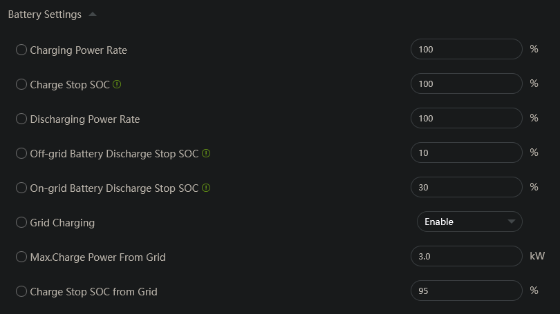

This is currently my winter-optimised set-up. I find that by stopping battery discharge at 300% end up recharging well overnight and having enough for self-consumption the day after without exporting when I need it. But perhaps may be improved?

@eliuccio What size batteries do you have? If you restrict battery discharge SOC to 30%, won't you be using from the grid at peak rates if you reach 30%? We only have 13 kWh batteries, so invariably end up dropping to nearly 10% every day in the winter. But, come April when HP is switched off and PV generation is in excess of 20 kWh, then we seldom go below 75%. But, for now we don't have the option.

Thanks, that’s a fair point and I agree the “right” floor depends heavily on battery size and the household’s evening load profile.
In my case the battery is relatively small (5.12 kWh), so the 30% discharge floor is a deliberate winter compromise rather than “never use the battery.” I’m on a single-phase 60A supply (in the process of being upgraded to 100A) with ASHP + EV in the mix, and earlier on I found the inverter modes could cause the battery to be “spent” at the wrong time (especially around EV charging), leaving me importing later anyway. With the current setup (Battery First overnight, Load First daytime), the battery reliably recharges in the cheap window and then supports self-consumption during the day. The 30% reserve mainly stops the battery being completely flattened before it can actually do useful work when tariffs are higher and PV is weak.
You’re absolutely right that if I hit 30% early in the evening, I’ll import at peak rates. In my own case, the trade-off has been acceptable because: (a) the battery is small, so it wouldn’t cover the full evening peak anyway, and (b) keeping a reserve has improved predictability and stopped the system “misbehaving” on EV nights. When PV improves (and once heat demand drops), I’ll likely trial 20% again, because at that point the risk of ending up at 30% too early is lower and the opportunity cost is higher.
Also, totally agree with your seasonal pattern: once you’re in April onwards and PV is routinely in surplus, the floor becomes much less relevant because SOC rarely gets anywhere near it.
