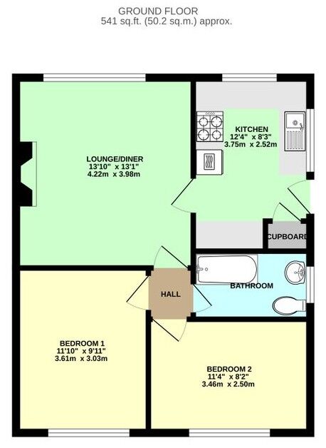

I live in York. Unfortunately while it would definitely be good for health reasons, those health conditions also mean we can't work. Because of this the system needs to be affordable enough both up front and durring use. It's a shame the grant for air to air is £5000 less. I could check with our council in case there would be any help available to cover any shortfall.
We live in a small bungalow. Its got room for a hot water tank in the loft right above where the boiler is currently. I've attached the floor plan in case that is useful.

Maybe, just maybe, if you are prepared to leave the doors open you would get away with a single 4 way outlet in that hall.  Possibly worth seeing what an installer says.

As an installer, not UK based, given it's a bungalow a single ducted unit in the loft with outlets / returns to each room and possibly an outlet only to bathroom, straight forward install, quick back of ciggie pack calc gives approx 9kw. One thing to note, if either of you have respiratory issues then AC may not suit you, it dries the air. Have you a heat recovery unit installed?
