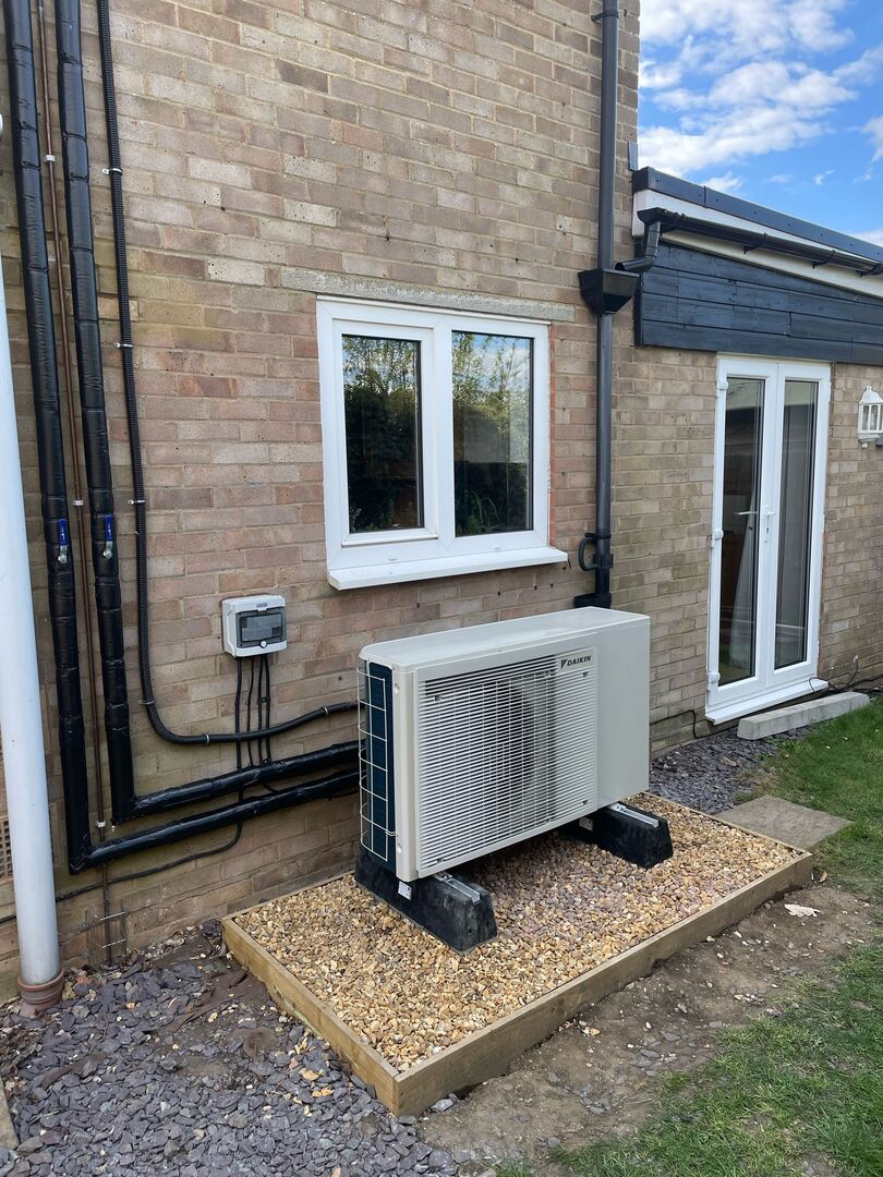

9kw monster swapped with the 8kw unit today - it's whisper quiet and running a treat so far! Well worth persevering with NAPIT as Octopus were reluctant to swap out the 9kw. Had to tweak the EmonCMS flow temperature sensor to before backup heater (as the 8kw doesn't have a backup heater) and updated the details on heatpumpmonitor.org
Looking forward to seeing how it performs next winter 🙂
