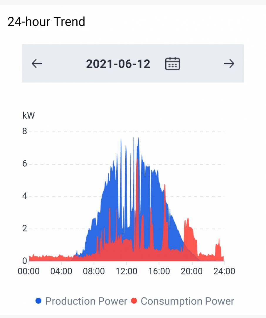

Below are the effects of hot weather, air conditioning and solar PV with battery. For context we purchased 0.24kw yesterday, we used 23kw and produced 52kw. At the moment we have no ASHP installed
Well done Batalto, I am pleased to see that you are using all available energy sources to reduce your carbon footprint as low as possible.
