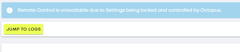

Just wanted to add something to this in regards to Octopus OIF and GivEnergy, which was the only reason I got the GivEnergy System, but now they expanded their apprived list for Octopus Intelligent Flux. Also talking about Hybrid Inverters, well, ALL systems have it, Tesla probably does it better than everyone, as it adapts to your use, so it starts to learn when you use the most electricity etc, and store it for that time.

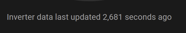

Going back to OIF, Octopus got smarter and are now locking users out of their systems. Also, I have no idea if they mess around with MODBUS, maybe DDOS, but my GIVTCP is falling over often now. Initially I thought I killed the hardware constantly sending commands and fighting Octopus, but Octopus is managing to control my battery just fine.
My setup is local laptop using Desktop Docker, I wonder if I should use something else. I did purchase one of those mini AMD PCs from AliExpress. I did so because the Raspberry Pi prices how gone up so much, they are no longer what they used to be.
Local Connection:
This is on the GivEnergy Cloud Page:
The annoying part is that the locking ability of the inverter was only introduced this year, and I doubt any of the users wanted and asked for it. I wish I never did the Firmware Update on it. FYI Octopus can lock your inverter FOREVER, the only way to remove your lock is to get them or GiVEnergy to remove the lock. Swapping Tariffs or removing the API Access will NOT remove the lock, isn't that genius, as while you battle to remove the lock, Octopus will continue to control your battery as they see fit.
I agree, @drei, that I dislike companies having control of my own stuff. However, the “I” bit of the tariff is, as we all know, “Intelligent” meaning the deal is a preferential rate in exchange for letting Octopus control your hardware. That’s not letting them share control; it’s letting them have control.
Personally I wouldn’t sign up to an Intelligent Octopus tariff since I don’t want anyone else dictating my choices for me, but if I did (to get that preferential rate) I’d have to accept my side of the bargain - to let go of the metaphorical steering wheel.
