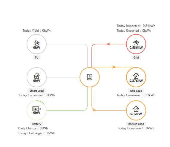

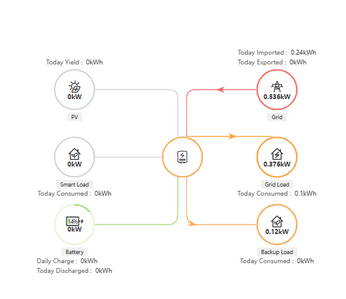

Via the cloud and via the online, similar data is shown. So far, just doing its job.
And if you can live with plastic surface ducting, your electrician will thank you for it.

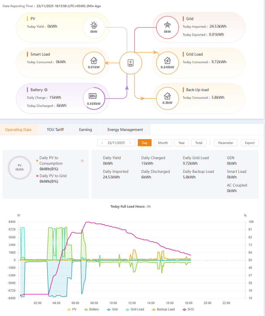

Quick update, Solis AI looks like work in progress. Had a few issues with it that HQ are looking into. The promise is worth the pain I think..
It also seems the smart port that is commonly used for AC solar input or a generator is also doubling as a second "lower priority backup" port. I do not want to assume it doubles the UPS capacity, but it does look like that.
Below is a chart showing the inverter charging the battery and then slowing down when the EV charger kicks in. With 100A there would be no reason to have to choose between the two as below 64A, it seems the Solis Engineers limited it like usual for Spain or Portugal...

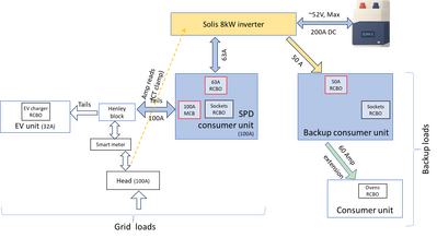

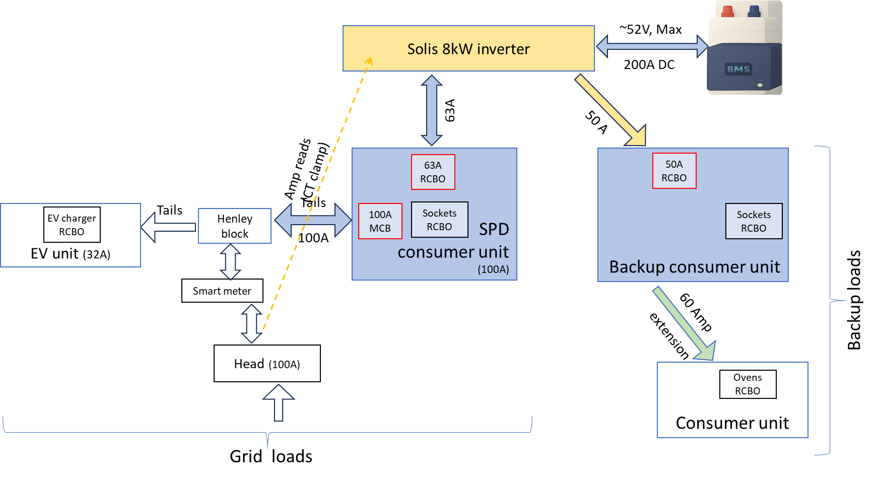

This is a simplified view of how we currently use the Solis inverter:
