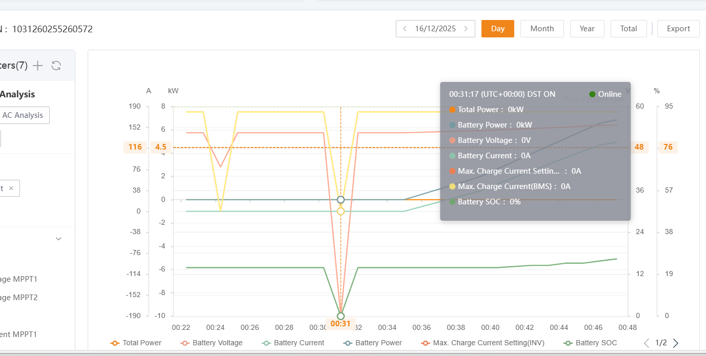

I had some glitch, which appeared to be with the inverter not working when I was setting specific periods to charge the battery. I raised this with Solis and their engineers say there seems to be a problem with the Fogstar battery - Seplos or JK BMS...
They shared the graph below. It shows that the battery is momentarily reporting a soc, voltage, etc of 0 and then it all changes back to normal. This is not normal behaviour...
I did upgrade the Seplos BMS firmware (absolute pain to get done a couple of months ago). It is the latest version 1.5 and it has been using the Pylontech protocol. Has anyone had issues with the JK BMS software, just wondering whether that needs upgrading?
Seplos show a few parameters that may need adjusting but I did not hear anything about these from Fogstar... https://www.seplos.com/11-seplos-bms-software-problems-you-might-face-and-how-to-fix-them.html
Posted by: @bashWhich BMS do you mean? You say you've upgraded the Seplos BMS firmware, but then go on to say JK BMS?
It can't be both?
My battery kit came with a normal bms (seplos) that I upgraded a few months ago.
It also has another board with firmware for balancing the cells (from jk).
I think the one sending the info to the Solis inverter is the seplos..
