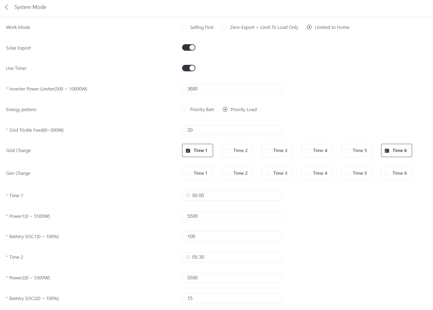

Milestone completed today, got my solar array working and attached to my Sunsynk Inverter.
6.4kW - running on X2 MPPT strings.
Question - is there any setting on the sunsynk that I need to consider? no export required (yet) but how does it decide to charge the fogstar battery, prioritise Load and/or charge from grid overnight?

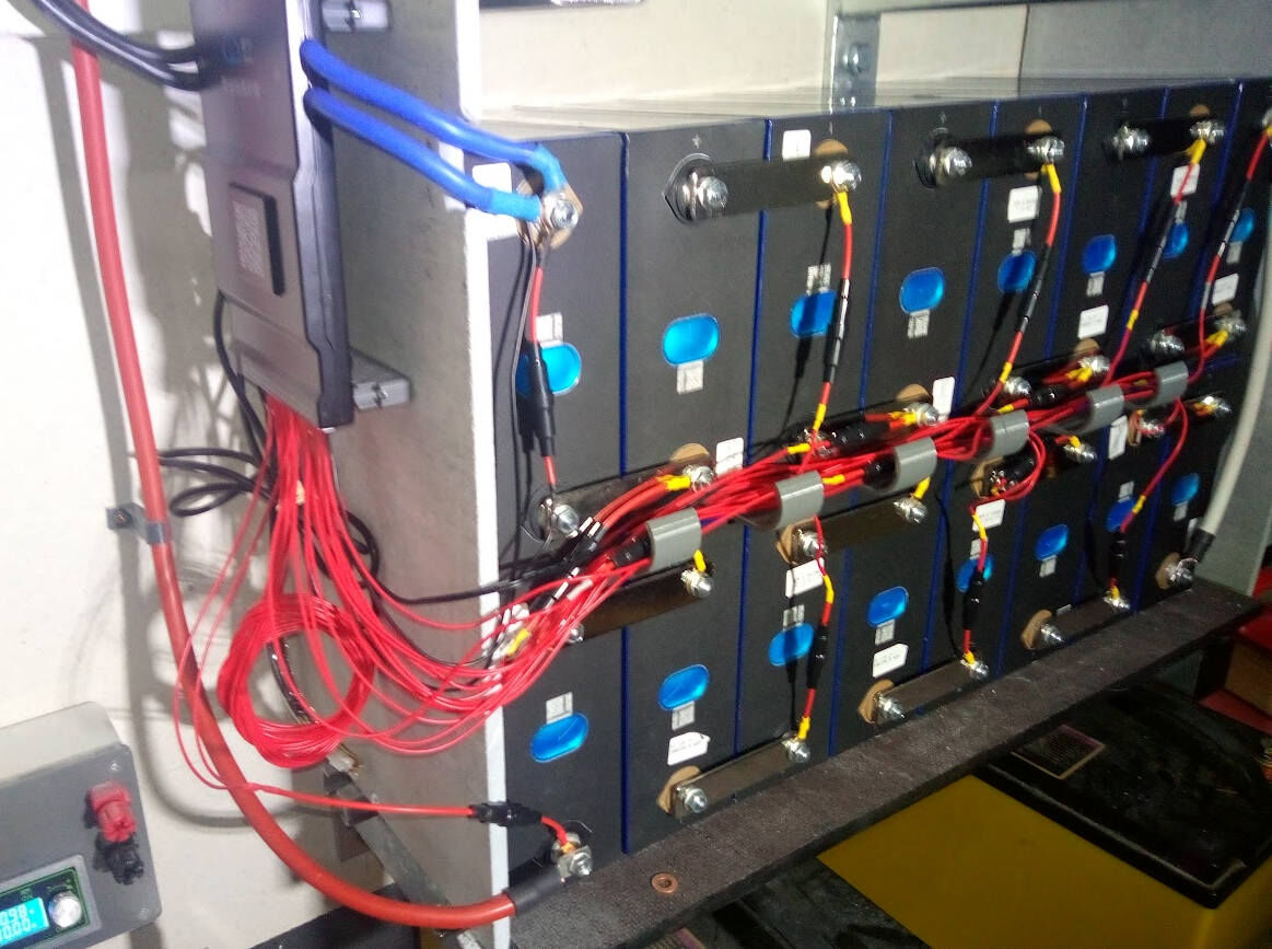

May I pick up this comment from last week?
As I understand it, you have a Jikong Active Balancer and a Seplos BMS connected to the same set of 16 LiFePO₄ cells.
There's nothing wrong with that strategy...
... provided both units have the connections they require.

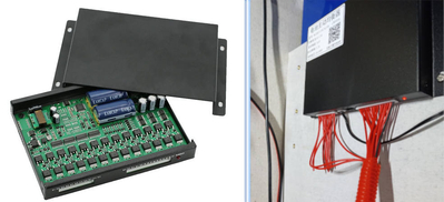

For the benefit of others, this is what a JK Active Balancer looks like:
aBalancer
It has only low-current balancing wires connected to each of the battery terminals.
That's 17 connections for a 16-cell (16S) battery.
The Active Balancer can handle up to 22 or 24 cells, depending on the model.
I've cut short the extra unused wires in the photo above.
A JK BMS is similar, but would also have the (large) wires which connect to the battery negative terminal.
JK use two blue wires in parallel to make that 0v connection.
CellWiring
The +ve connection to the battery doesn't go to the BMS unit, but straight to the inverter(s), via whatever protection devices you've decided to have.
Since @batpred has a Seplos BMS unit, I would expect it to be positioned on this 0v connection route to the battery negative terminal.
A photo would be useful to clarify that.
So how does that Seplos BMS 'know' the overall battery voltage?
It should have one thin (red) wire connected to the +ve battery terminal.
Ie it's not going to do any balancing between cells, but still needs a voltage to power itself!
That is also the wire which tells the BMS what voltage the battery is currently at,
which it passes on to the (Solis) inverter using the CANbus or RS485 data connection.
Do you have that one red wire present @batpred ?
And where is it connected to on the Seplos BMS?

(@sheriff-fatman)
Posts: 224
Posted by: @ggw
SITREP #5 (I think)

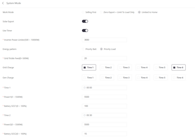

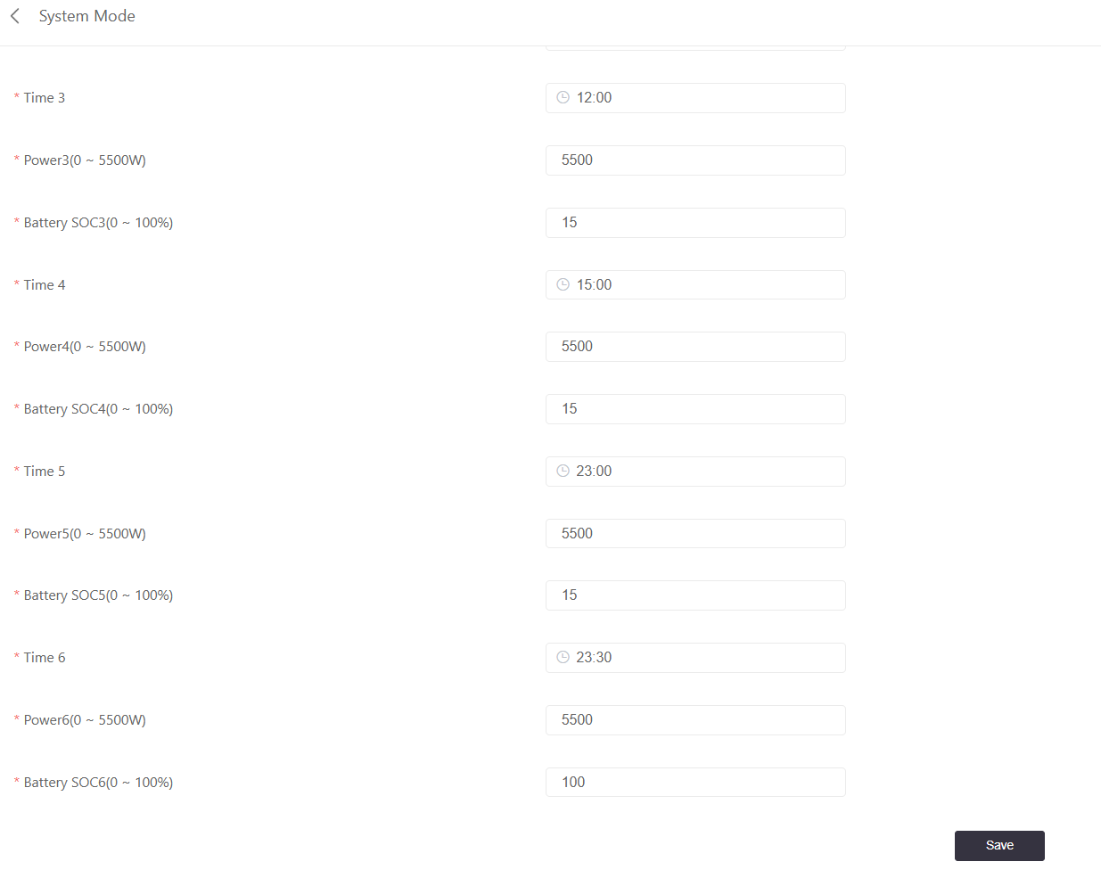

The settings for this are accessible via either the app or the website, and are found the Equipment tab, then the 3 dots and 'Settings', which will show up the System Mode option.  On there you can switch export on and off, prioritise the load and set timers (screenshots show how mine are set).  There are 6 slots available, that have to start and end at midnight, but it's only the ones that are ticked in the boxes near the top that trigger grid charging to whatever % level you set.
The minimum level you set is also relevant as the system will revert to grid operation if you hit one of these numbers, which is mine are set to 15 when I don't want it to be grid charging.  If this was set to 50 in any period, the batteries would only discharge to that level before switching to grid power.
Hope this helps with your configuration.
